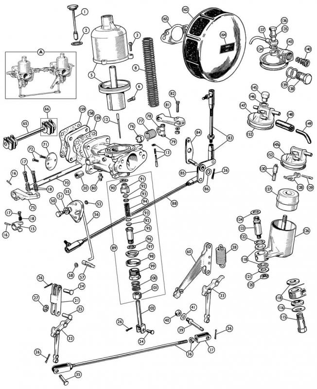

Does anyone know if copper washers 90 and 96 can let extra fuel in?
steve

If your jet is 3/16" below the bridge , I think it could be the cause of your rich running problem. Normally, I think the jet height should be about .050" below the bridge. Sometimes the old washer (#90) isn't removed when removed when the carbs are overhauled and a new one added, which makes it impossible to get the mixture lean enough. I fought the problem on my TR3 many years ago and solved by machining about .020" from the upper jet bearing. A dial caliper is helpful in measuring the jet height.

Berry I believe I have got the carbs back together correct and I see what you mean about the washer. My thoughts were those thin copper washers are there to help with the sealing and yes the lower is more of shim and I have seen different thickness. The brass washers are probably there to help the matting surface and not so much sealing the fuel out. But I do remember the assembles looked a fuse different and I have a few of those bearings so I will not forget that adjust you mentioned. I did move them in from the 3/16 but have not looked at where I am at know.
The more I think about it seems these carbs are very simple and if put together by the book with 7/16 float and the piston dropping it should work. My thoughts on the brass washers being a sealer is probably wrong; it looks like the fuel is held in the pocket between the glad washers and if a small amount goes around the assembly it could be made up for in the adjustment or it would just leak a little.
<snip>

You were correct the first time: That thin copper washer between the upper jet bearing and the carburetor body is very much intended to work as a seal and to keep fuel from bypassing the jet by flowing around the jet bearing. I also have seen different thicknesses for this seal. Unfortunately. They're supposed to be 1/32" (0.031") thick. I frequently encounter ones that are considerably thinner, usually 1/64" (0.016") thick. Such thin washers are frequently supplied with rebuild kits. They will not work, but the unknowing buyer installs them anyway, and he instantly has a problem that he never had before. Two things go wrong:
1. Fuel bypasses the jet, causing an overly-rich mixture, no matter how much the jet is adjusted.
2. The jet bearing (usually) cannot be tightened sufficiently to hold it in place while turning the adjustment nut, so the mixture can't be properly adjusted, whether or not the fuel is bypassing the top jet bearing.
To check for this problem, you need to turn the adjustment nut all the way up, and then keep on turning it... if you can... If you can continue to turn the nut after it's all the way to the top, then you probably have one of those too-thin copper washers. If you can't turn it, then you're probably okay.
Someone on this thread mentioned machining 0.020" of material off the upper jet bearing. That would be a mistake, leading to the exact same sort of problem as installing a too-thin copper washer.
Of course, if the top gland seal is leaking, that too would allow fuel to bypass the jet orifice and could result in an overly-rich mixture. Cork gland seals can leak. Teflon o-rings (-010 size) are far superior and are readily available. See:
https://www.theoringstore.com/store...product_info&cPath=367_93_96&products_id=4168
You need two o-rings in place of each cork seal, four o-rings per jet, 8 per pair of SUs.
