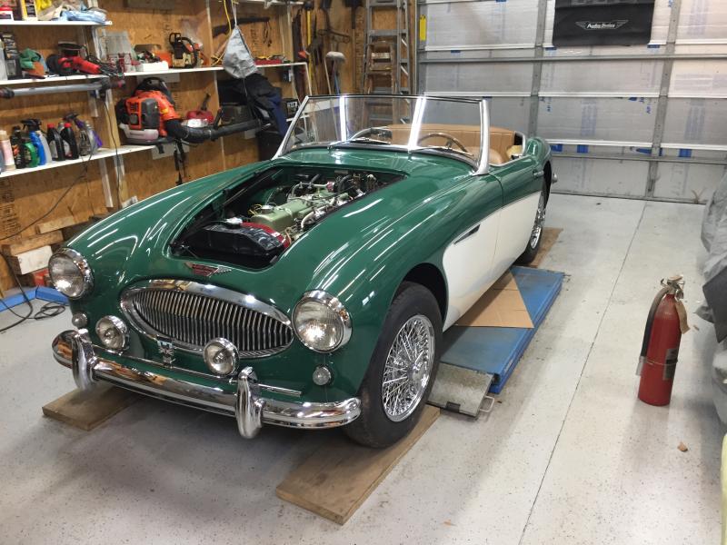

so i got her started. first time in 15 years i believe. my goal was to get it running and run it at about 2000 rpm for 15-20 minutes. all new valves and springs, etc. So i did accomplish my goal.
it wasn't a real success all the way around however.
don't know if i posted before but i first pulled off the oil line to the gauge until i had oil come out. then in a few cranks i got the oil pressure up. next before i put in plugs, i wired up the fuel pump and pressurized the fuel system.... first problem. my front carb had a sticking needle valve. so i pull that out and blew it out with air. put it back in and problem solved. good so far...
i could not figure how to get it timed (pertronix) so i set it close and just went with that. went thru my check list one more time; got out my fire extinguisher; made sure the garage door was up and nothing behind me in case i needed to back it out; and then double checked all the fluids.
all looked good so i figured.. what the heck... and i hit the starter button. i was getting some fire but it had that sound of wrong compression. once before i had that with my dad's model A and we had the timing off. so i advanced the timing and tried again. it took a few tries but then it fired up. the engine ran right up to 2000 rpms and stayed there. i pushed the choke off but it did not change. i only had the idle screws turned one screw in but i tried to back them off a 1/2 turn. no change.
i wanted to run it at 2000 so i let it go as it was and just kept an eye on the temp gauge. at about 190 i noticed some drips of something on the fender. i looked down and the thermostat housing was starting to leak... well not really starting, it was leaking. i was about 10 minutes in to my run so i tried to hold a rag there to keep the fluid from blowing everywhere. fought thru it for about another 5 minutes and by then the temp was approaching 200. i figured that was enough and i shut it down. put more rags around the cover and decided it was time to go sit on the front porch in the rocking chair and have a cigar.
don't under estimate the power of a good cigar.... after about 15 minutes, it hit me... i bet i did not tighten up the vacuum line on the distributor. i bet that thing was sucking air like crazy. sure would explain the high RPM. dummy. too excited hearing it run to think i guess.
after it cooled (and i finished my cigar) i went out and pulled the cover off the thermostat. i knew it was sketchy at best since it was pretty corroded. So i have ordered a new one.
good things: i held 60 psi oil pressure for the whole run. i did not see any oil leaks with the engine. i saw no leaks around the head gasket. no traces of oil in the anti-freeze / see below and oil looks good as well. it ran very well, albeit 2000 RPM. i did slow it to about 1000 with the timing before i shut it off.
bad things: well the cover of course. although that is an easy fix. i brought in the thermostat to make sure it was opening all the way by placing it in a pan of water on the stove. it was new but you never know. i also have a leak at the radiator drain tap. i bought a new one from Moss. i did not use their plug in it and yes it leaks. if i wanted to use a plugged one... why not just use a plug. does anyone use a different brand tap there that holds? i have since put my old one back in.
So it was semi-succesful. i wanted to set timing anf the carbs but never got to it. i have Pertronix and was reading about trying to static time... they are not to be used with solid core wires. That sucks. So i also ordered a set of points and a new condenser with my cover. they are realatuvely cheap so i am going to put them in and see how it goes. really i don't drive that much. Maybe just keep an extra condenser in the tool bag.
so that is it for now. i still have some oil coming from the O/D lever on the side of the tran and have also noticed now a little oil coming from the front of the rear diff. both things i did not touch, other than to paint. the tran was a rebuilt one never used and the diff was supposed to have been gone thru.
i have capped the vacuum line so it will not be a factor next time i am ready to fire it up. need it capped to set the timing properly anyway. then i can uncap and make sure it is tight. or at least isolate if there is a vac leak and where it is.
IMG_2240.jpgnote the fire extinguisher... think i was a little nervous....
Woo hoo!
Yes, a good feeling, and it didn't sling its innards, so chalk that up in the good column too.
A brand new engine is going to be a little tight and run on the hot side; I'd have let it run out the next five (>5) minutes, and not pulled the plug unless it was still climbing at 220* (ignition timing factors in here as well).
Go over all your checklist items, and give it another shot; tomorrow or ? whenever the urge strikes you (note: neighbors tend to be less supportive after 11:00 PM-Midnight, so don't let enthusiasm get the best of your judgement ;) ).
Yep, that's a good feeling :cheers:
Well waiting on the thermostat housing right now.
See if you can find a good strong floor fan to help force air into the engine bay while its running . I have one of those fans they use when your house floods and they try to dry the carpets etc with it .
Congrats on getting it running . I know I jumped up and down like a kid in a candy store when I got the 67 running for the first time , that was my first full engine rebuild .
Then I realized I had to clean up all the mouse crap etc that blew out the exhaust up the wall in the garage .
Just get it running at a good fast idle 1500/2000 rpm and tweak it play with the timing carburation and just enjoy the fruits of your labour .

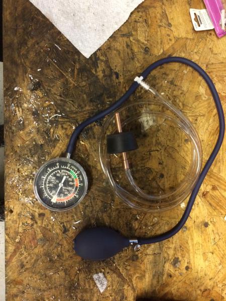

Do it right , get the repair welded , correctly . All you have to do is drain it let it dry throughout and make sure when they weld it its not sealed in any way , open to the atmosphere
yeau, i just wondered how a welder could find a pin hole to weld? there is a guy accross town who has a good welding business. i can check with him.
But then who knows if this tank develops another problem later. if it is going to cost me a 100 bucks, i may as well spend 200 and get a new tank. Get one from Moss and if it leaks, they can replace it.
just don't like to guess when it comes to gas....
Compressed air and soap solution and mark where you want him to weld it.
leave the sender unit in use the outlet tube for pressure 1psi max get a plastic/ rubber plumbers test bung for the inlet opening .
