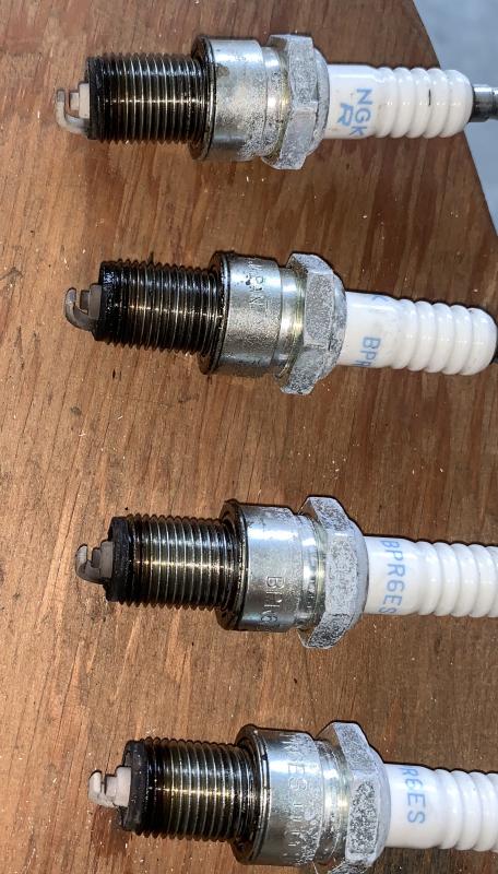

Update...new fuel pump, filter and she runs well, but symptoms persist if I run at a steady high speed. I can let off the gas and it will catch up and run fine. The engine runs just a touch cooler than normal on the gauge and nothing to indicate anything is amiss, but I now have a little run on when I turn it off...same gas as always, timing unchanged, plugs look good, etc. I’ve got a friends MGA taking up the MGBs space in the shop and I’ll dig into it some more once the A is gone. Just for grins I’ll post some spark plug pictures.
Rut

Assuming good methodology (And I know ya Rut, so confident the plugs are in order!), odd the two middle ones appear to be running richer than the outer ones, and considering the firing order, could you be seeing a distributor/cap/rotor issue as a combination with coil/wiring contacts?
"If you've got carburettor problems, it's probably electrical!"
Just thinkin' out loud.

They are in order and I thought the same thing. I had the distributor rebuilt by Advance and he set it up to match the engine mods and I’m using points. I’ve also removed the vented cap just in case, but the symptoms still exist...it’s a minor problem, but one that puzzles me. I’m going to install a dual AFR meter so I can get an idea of what’s happening and different loads and RPM...I’ve got one on the bugeyes 1275 and it really helps.
Thanks, Rut
