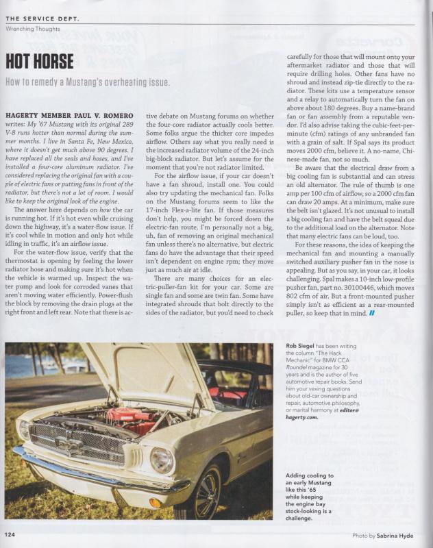

My take is these cars have always had this issue, they were perhaps more 'accepted' as we didn't expect as much performance and reliability from cars of that era and took overheating, etc. in stride. The early Mustangs were known to overheat as well, and our '65 behaves much like my Healeys. A Healey owner on the email list informed me that he solved the problem in an early Mustang he bought for his daughter with an aluminum radiator; I may take this approach as early Mustangs aren't all that rare, I'm not that concerned about originality, and it it really needs a brake upgrade as well (my dad was a factory rep for Ford and confirmed these were known issues with these cars). My '96 Ford Ranger--with the 4.0L 'Cologne' engine ('German steel')--had a defective thermostat from the factory and never reached running temperature until I replaced the thermostat (which still bounces around erratically).
