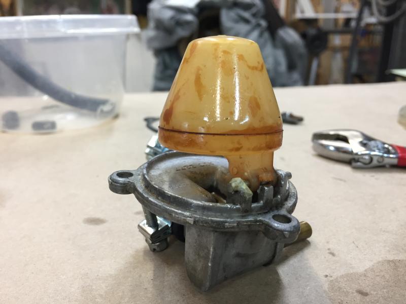

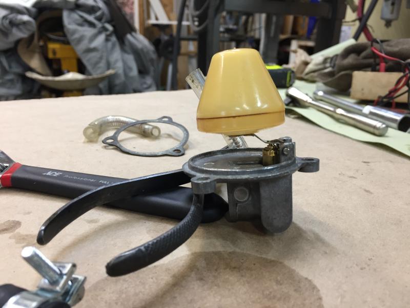

here is a picture of what one looked like.
now i thought that the float in this position should sit about 1/8 off the top ridge. but i have also read that some people were pressing down on the spring loaded needle valve to set the height. is this done differently for different needles? ceartinly this one is about 5/16 or more off the top in a resting position.

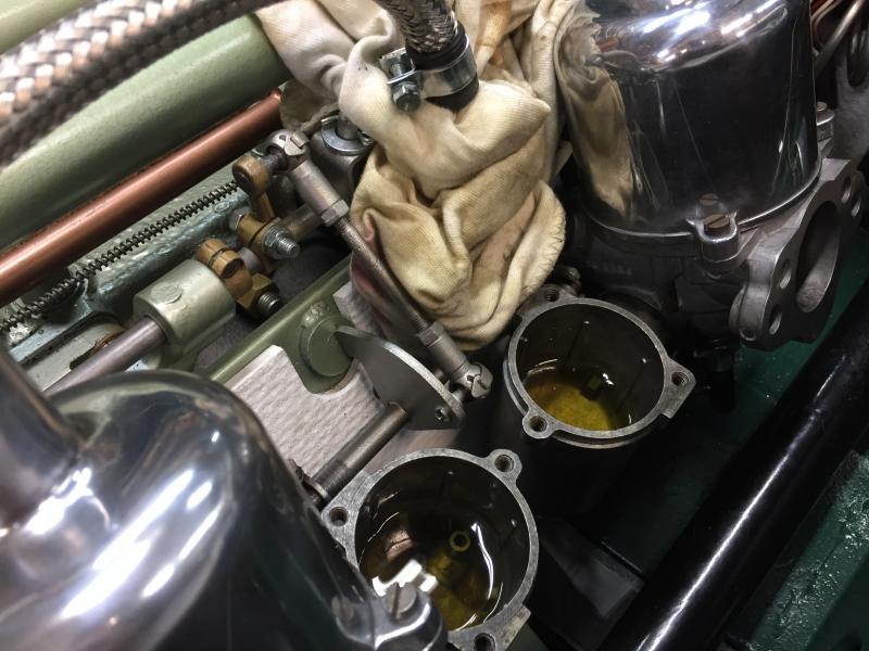

if you look in the chambers this is the amount of fuel that the height adjustment allows. about 1/3 of the chamber has gas in it.
That looks low to me. but wanted to check with people here who know.
also it looks like someone broke the middle float cover and glued the float pin to the lid. it works ok but not sure i could ever change the needle or adjust if necc. So now i need to find a middle carb float cover. Doesn't look like Moss has them which may be why someone just tried to glue this one.
