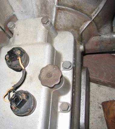

Roger Williams mentions a 1/16" breather hole "at the front of the gear change extension," that might inadvertently be left blocked, causing serious oil leaks. Does anyone have alternative (better) instructions for locating this hole? I can't find it.

Far RH edge of this photo, near the upper bolt hole.

Looking at my spare gearbox (from a 64 TR4) I do not see the hole shown in the above picture. A cursory examination did not reveal any other obvious vent.

The photograph was very useful. Now I know why I've not been able to find that hole. I also know why all those gallons of oil disappeared over the last decades.

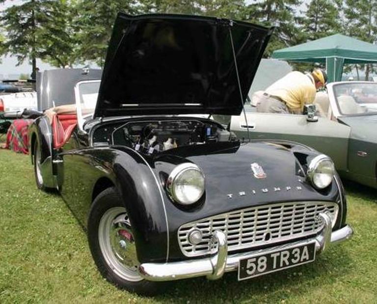

Perry - The cover you show is not from a 1958 TR3A or else your TR must have been built very late in 1958. My 1958 TR3A (TS 27489 LO) was built in February, 1958 and it has the hole for the dip-stick as shown in my photo. The photo you show has no top dip-stick fill hole, so I assume that you have to fill the gearbox via a hole over on the LHS. I don't have the fill hole or plug down on the LHS of the gearbox housing. Note that mine does not have that vent hole it the top cover either. But with the dip-stick in the hole on the right, I have to assume that any pressure build-up might have vented itself via the dip-stick hole even though it's a loose/snug fit with well oiled felt about 1/16" thick wrapped and glued to the outside diameter (about 3/4" or 1") of the dip-stick.
Also the connectors for your overdrive cut-out switches have push-on spade connectors and S-T didn't start to use these till after TS 60000 about 1960. Mine show the screw-on connections.

Good point, Don. I believe the dipstick was deleted at TS50001, same time the bellhousing changed to accomodate the later starter. That change point was in early 1959.
There have been at least a few people that tried to swap a later top cover onto an earlier box, and had no way at all to fill it (except turn it upside down and use the drain :laugh: ).
The vinyl OD harness & Lucar connectors also suggest that Perry has a later box.
I'm sure I've got at least one example of a later 3A top cover up in the attic somewhere. I'll try to dig it out and see where it's vent is.

Perry - I bought my 1958 TR3A brand new when I was an adolescent - only 20 years old. I paid cash with the money I saved between high school and age 20. It has survived all these 51 years. So have I. I'm still an adolescent.

So maybe we can guess from this that the gearbox breather hole became a reality at about TS50001 (after the dipstick disappeared) and lasted only through the TS series (TS82xxx?). So TR3B, 4, and on had no such amenity. And, presumably, all leaked like sieves.
