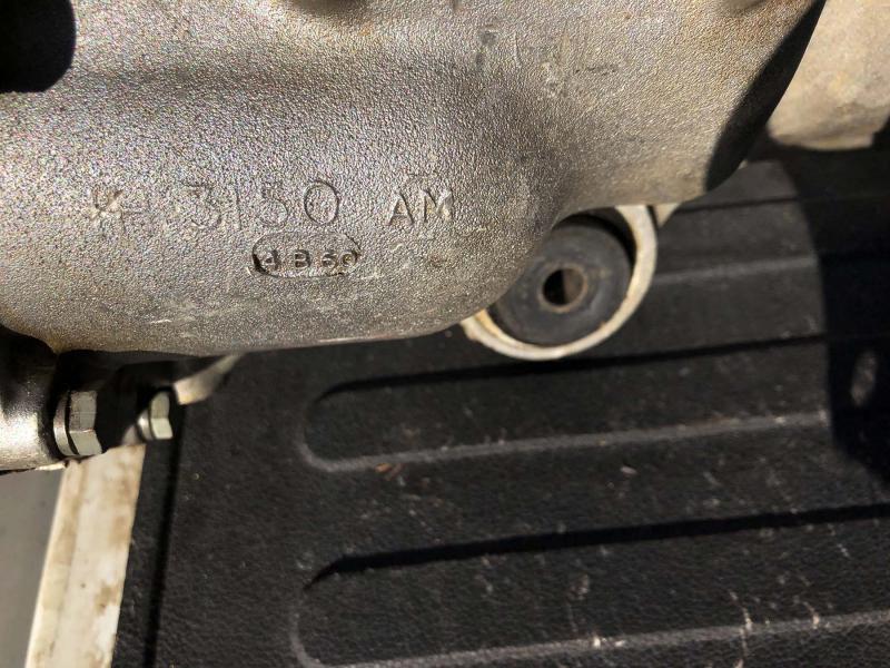

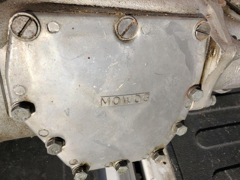

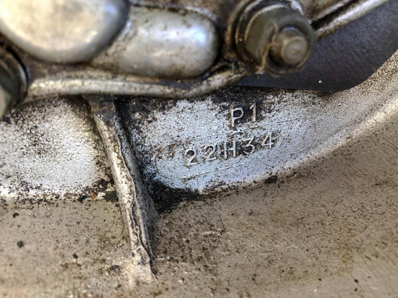

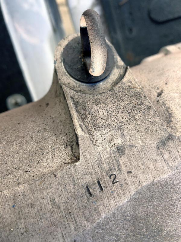

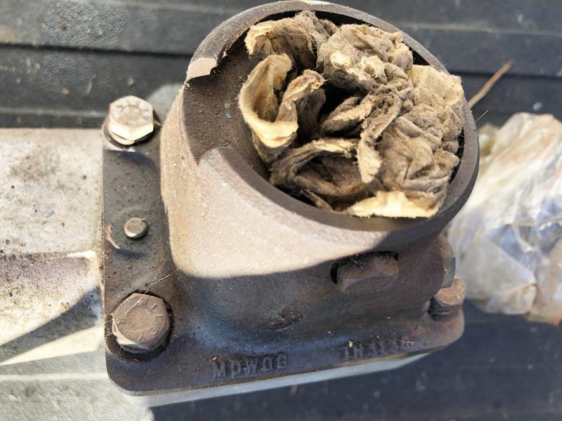

I wonder if someone could please positively identify this gearbox:
NOTE LARGE CUT-OUTS IN BELL HOUSING.
Thanks to whomever can make a positive identification.
Top mounted slave cylinder, 10-spline input shaft. MG ZA or ZB Magnette.
Magnette as above. Also used on TVR Granturas.
