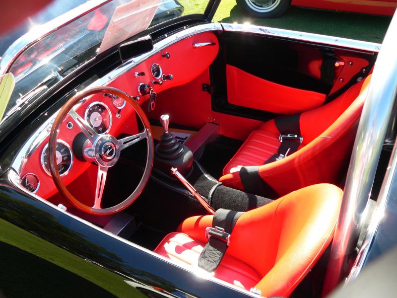

Another fix that may need done is because the shift stick doesn't come up in the center of the hole any longer. One method is to get the gaiter ring from a later car and use the leather gaiter instead of the (remove able) shifter can. I was lucky to know a guy who could weld. I had him cut 1" off the height of the can and fill in the hole. He then redrilled the hole effectively moving it forward. Got a rubber gaiter for an MGB and away I go.

Agreed on the MGB Gaiter. That's what I did. just leave the first 2 rings underneath the opening in the turret. And Bill since main wire harness is not installed yet, starting the engine and tossing in a broomstick is not an option. Carpet is not yet installed. And I'm assuming you did this on your MkIII Sprite.
There is some mention of the "later Midget"gaiter I think in the 11 pages of instructions. I'm a little confused on this issue. Are you saying to keep the can, maybe modified a little, and add the gaiter to it or ditch the can completely and put the gaiter directly on the tunnel? Also, the idea of tossing a broomstick in the tunnel is kinda scary. I will check the rear mount very carefully. It sounds like we may be fitting this thing twice.
Using the later gaiter ditches the can. Have a look at the moss catalogue pictures and you'll see. It's probably the easiest solution. And, YES throwing the broomstick up the tunnel at the same time the clutch gets engaged, the resulting noise and pounding IS scary. The broomstick gets destroyed in the process. You may need two of them.. BOOM BOOM rumble rumble BOOM BANG BANG.

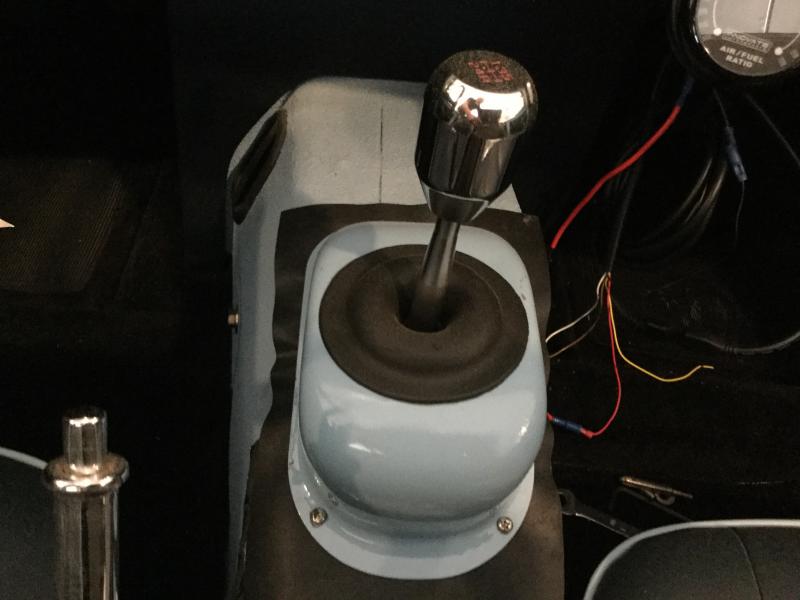

I like the original top hat and rubber...I also added a thin sheet of rubber below the top hat to prevent fumes from coming in.

I like the original top hat too, but found the shift a little stiff with the OEM boot. I enlarged the hole and used a MGB shifter boot.
I really like that solution.
