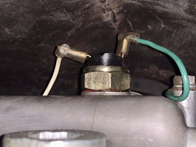

Gents, I have to replace the gearbox swith of the overdrive system. From my understanding it seems to be a simple task even if the gearbox is in the car: detaching the two electric wires, remove the old swith, screw in the new one and attaching the wires again. Is that righ? Do I have to pay attention to what so ever?

That's it in a nutshell. That is assuming you already have the interior out. I don't think there's any way to loosen the screws to disconnect the wires on an original type switch with the tunnel in place. The replacement switches have push on connectors.

My hope was that I can replace the switch from under the car without the need to remove the interior and the tunnel. It is looking like this currently.

Looks like you have the newer style switch with push-on connectors already, so you should be good to go. I found that one of my switches was so close to working or not that if I left out the fiber washer it worked, with it in it did not. I smeared the threads with sealant and left the washer off.
