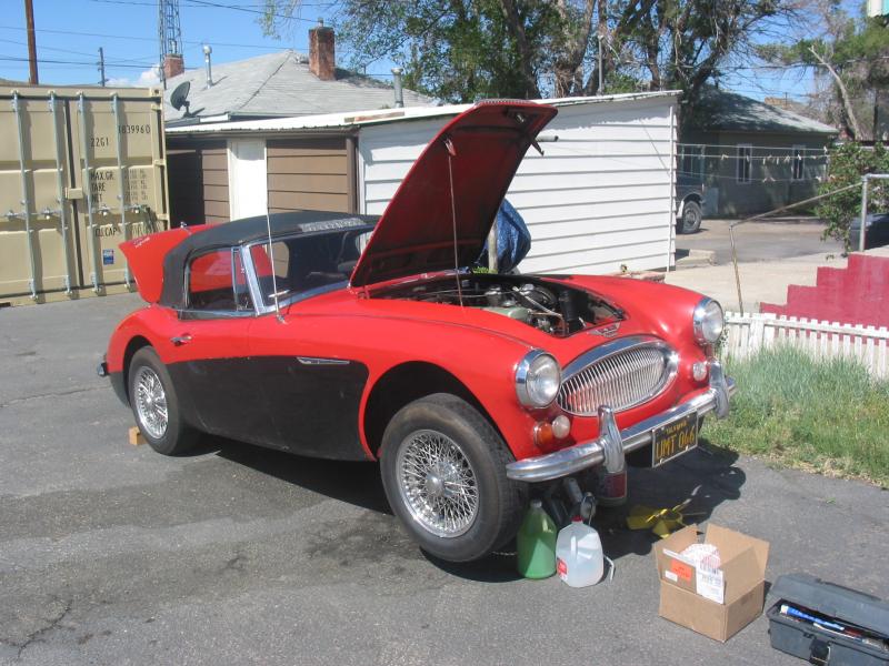

Overheating BJ8
I assume you are having overheating issues? This topic was covered extensively recently on the autox mailing list. I've copy/pasted some responses here:
