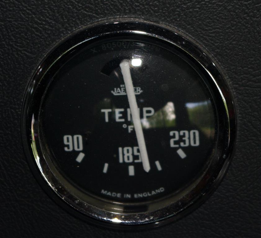

Thanks for the extra information re pumps. Just ran up to temperature at idle and it sat at 185 for about 5-6 minutes. Bypass got warm quickly. When idling, top hose (it is one of the ones with fabric covering so some insulation effect maybe) was warm but I would not call it hot. Thermostat housing was hot. The bottom hose took some time to warm up too and near end of idle period it was hot (while top was warm) based on my hand but no fancy IR thermometer. When I shut off engine temperature climbed a little (see pic), which I think is normal.
