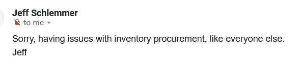

PS - sent an inquiry to Jeff re whether he still sells parts.
Edit: his reply:
