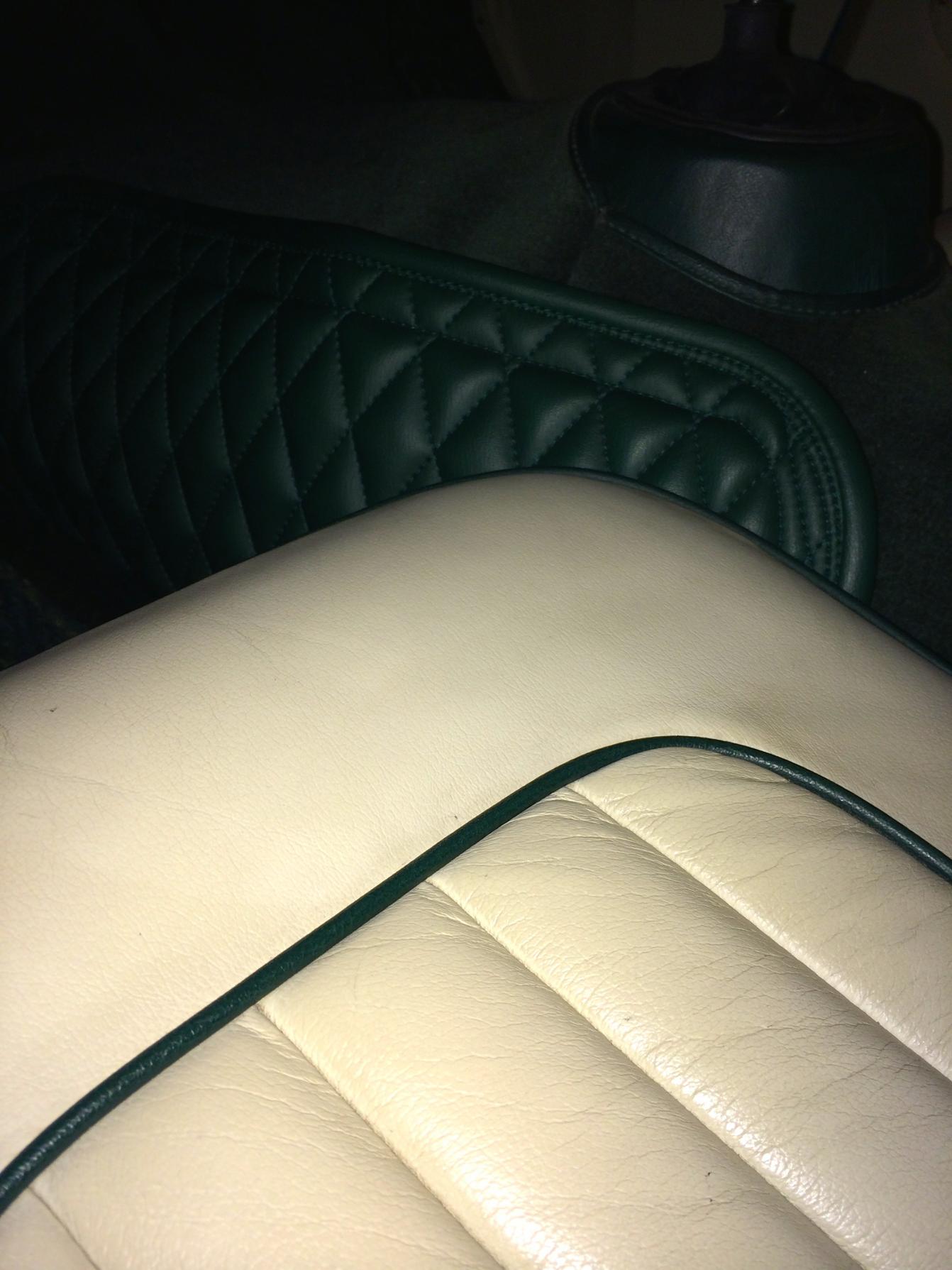

60TR3A
I wish I could do that but since my car goes back and forth between Miami and Woodstock, Vermont, it gets too cool up here to go w/o a thermostat, even in summer. I had an upholsterer make a nice pad that sticks to the transmission tunnel by Velcro which gives my right leg some relief on very hot days.

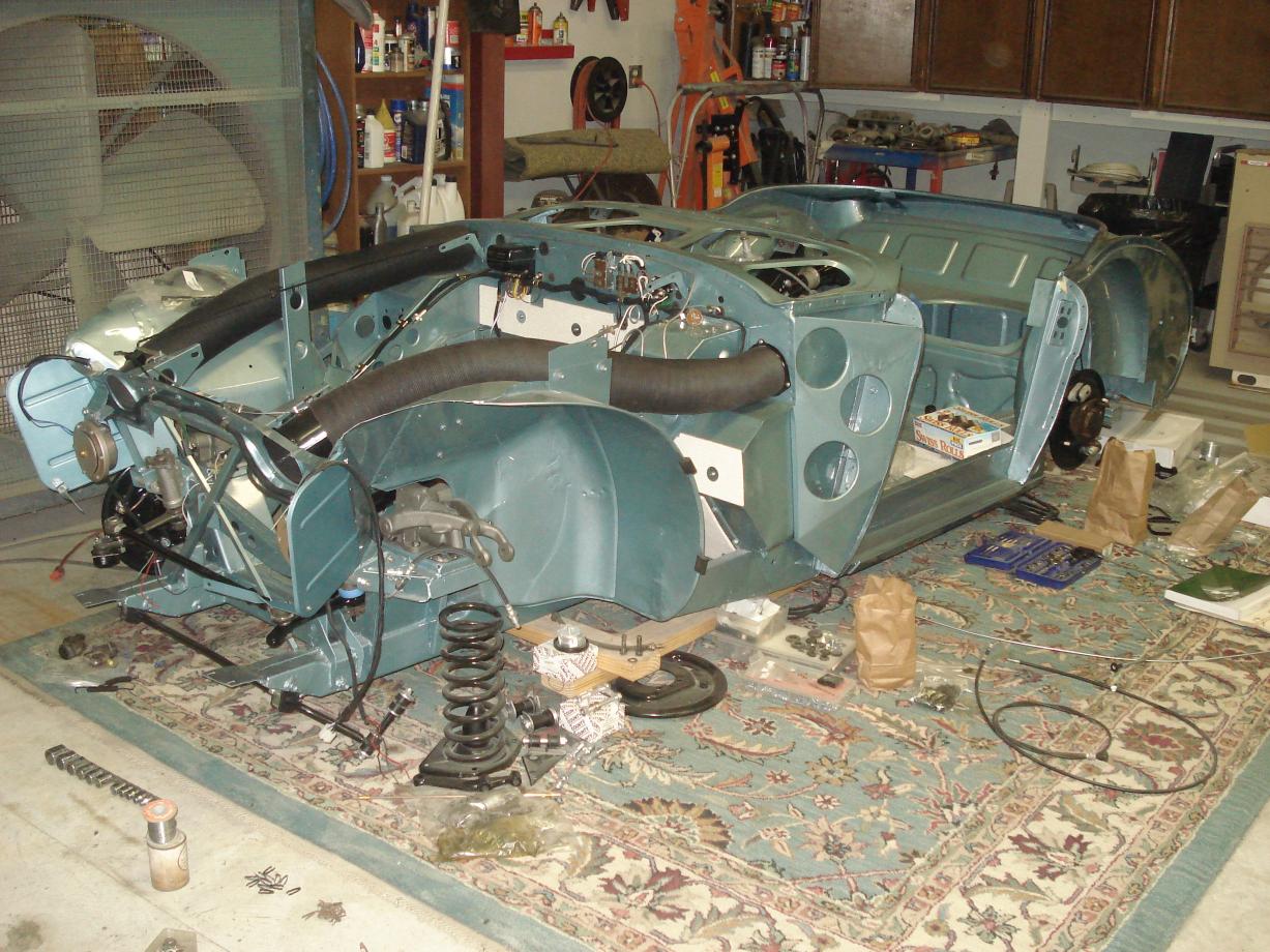

healeyblue
Same ideas here. No heater and straight ducting. plenty of heat shielding and padding. We are running a hardtop on the car now and still have zero issues with heat in the cabin.

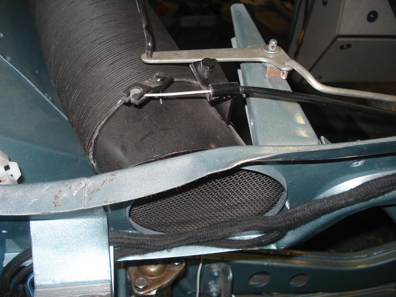

R
RDKeysor
Bronze
Very nicely done, Healeyblue. I see that in addition to using a single continuous 4" hose for your fresh air and bypassing the heater fan, you have also fitted a cable-controlled valve similar to the one on the driver's side air intake at the front cowling. Very neat. Mine just blows straight through. Truly amazed that you aren't experiencing heat issue with a hardtop. One of my Healey books depicts a couple of close cars that Donald Healey had built and drove, and heat was apparently an issue on those cars. I have yet to flush the block and replace the water pump on my car, but I have those ideas in mind.
