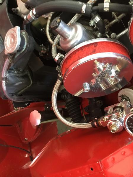

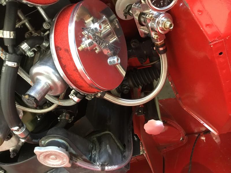

Maybe a small expansion tank would help?
Works for me
SD Bugeye
Mm not sure what the issue is with the picture upside down
I have a small tank stainless steel mounted on the side of the radiator
Good point about the shrouding. The early bonnets had no shrouding and many fiberglass units do not have any.
Joe Schlosser
Trevor
I dropped the operating temp at 65 Mph by 10-15 degrees by adding some aluminum aroind the nose plus some foam to seal against.
