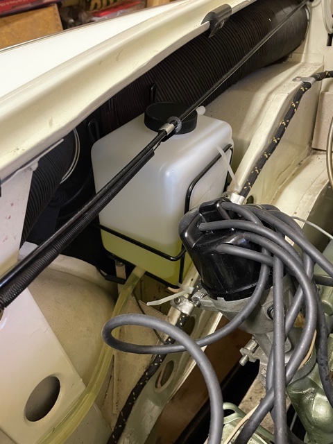

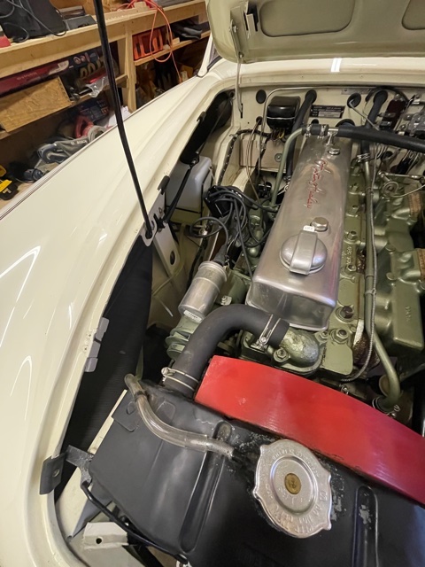

Thanks for the detailed reply, Michael.
I attached photos of my tank setup. Since the container which is vented at the top, was pre-filled with enough coolant to keep the inlet tube fully submerged, I would think it should allow coolant to return to the radiator as the engine cools?

Since your tank input is on the bottom, it'll work fine for recovery. You need an additional thin gasket inside the cap in order for the recovery to work.

I will add a thin rubber gasket under the radiator cap...a piece cut from a fat bike inner tube should work. This probably accounts for the fact that I never see any fluid being drawn back into the radiator. Actually I was low on fluid, and yes this behavior is coincidental with installation of the expansion tank. I’ll report back after the gasket is installed. Thanks all for your responses.
