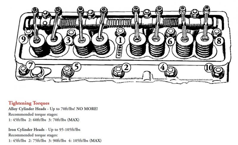

I just checked the #1 bolt to tighten in the head torquing sequence and it about 1/2 turn before the torque wrench clicked at 100 ft pounds.
