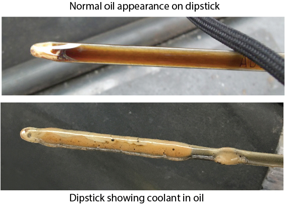

Let the car sit over night. Then check the dipstick in the morning. You want the coolant to separate from the oil (if there is indeed coolant in the sump). Coolant on the stick would be less shiny than the oil, and probably a greenish tint (if it's common coolant). Or a greenish/brown tint if there's a lot. Here's a photo that might help:

Thanks for the pix, that helps.
My car's been already sitting a couple weeks while I do a bunch of winter stuff. Coolant is drained. I checked, and the oil looks/smells normal, like first photo, just a little darker, which reminds me that I need to change it. So it looks like we have a one way transfer, oil>coolant.

unless you drained the coolant into the drain pan you generally use for changing oil. Guess what will float right up to the top?
As far as looking at the oil.....dipstick, if it looks like a "milkshake", coolant has semi-homogenized after being perturbed through the oil pump.
However, you will also see it under oil fill cap (high point) and if you pull the rocker cover.
