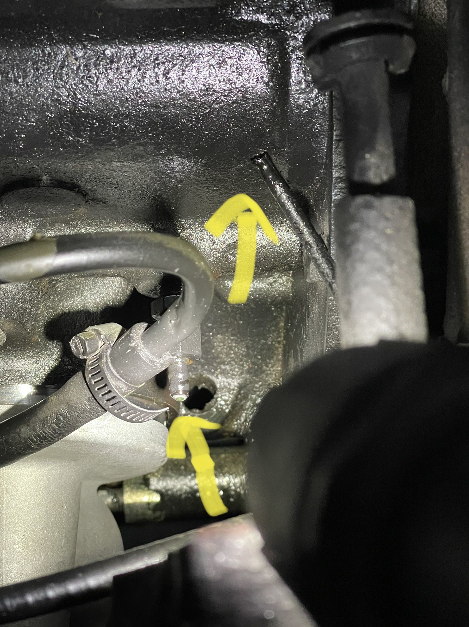

Ok replaced the filter assembly with the after market fix but the oil continues to spray out of the valve I’m attaching the pics of the new filter and where the oil is straying out. Thanks for the help!!

Ok replaced the filter assembly with the after market fix but the oil continues to spray out of the valve I’m attaching the pics of the new filter and where the oil is straying out. Thanks for the help!!View attachment 73545
The fitting that the arrow is pointing to should have a line to feed the oil pressure gauge.
Does your oil pressure gauge work?

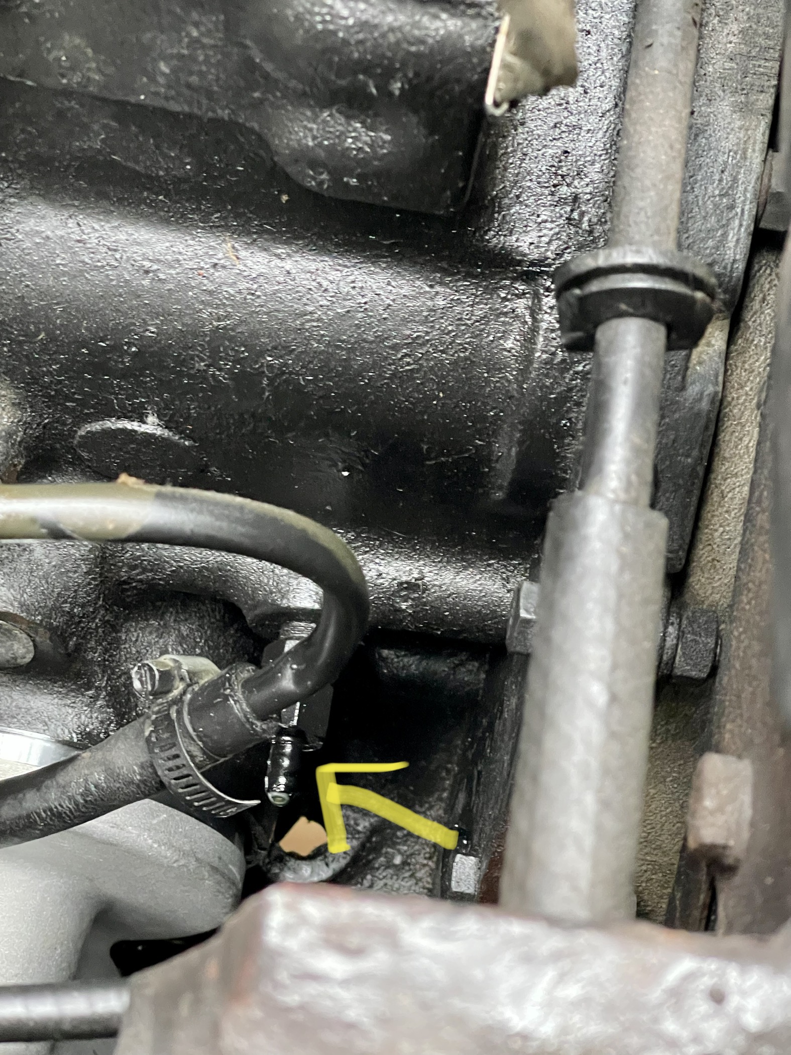

You are absolutely correct- I found the broken line - please see the pic. Any idea where I can find a replacement and the exact name or part number!! Thank you again!!

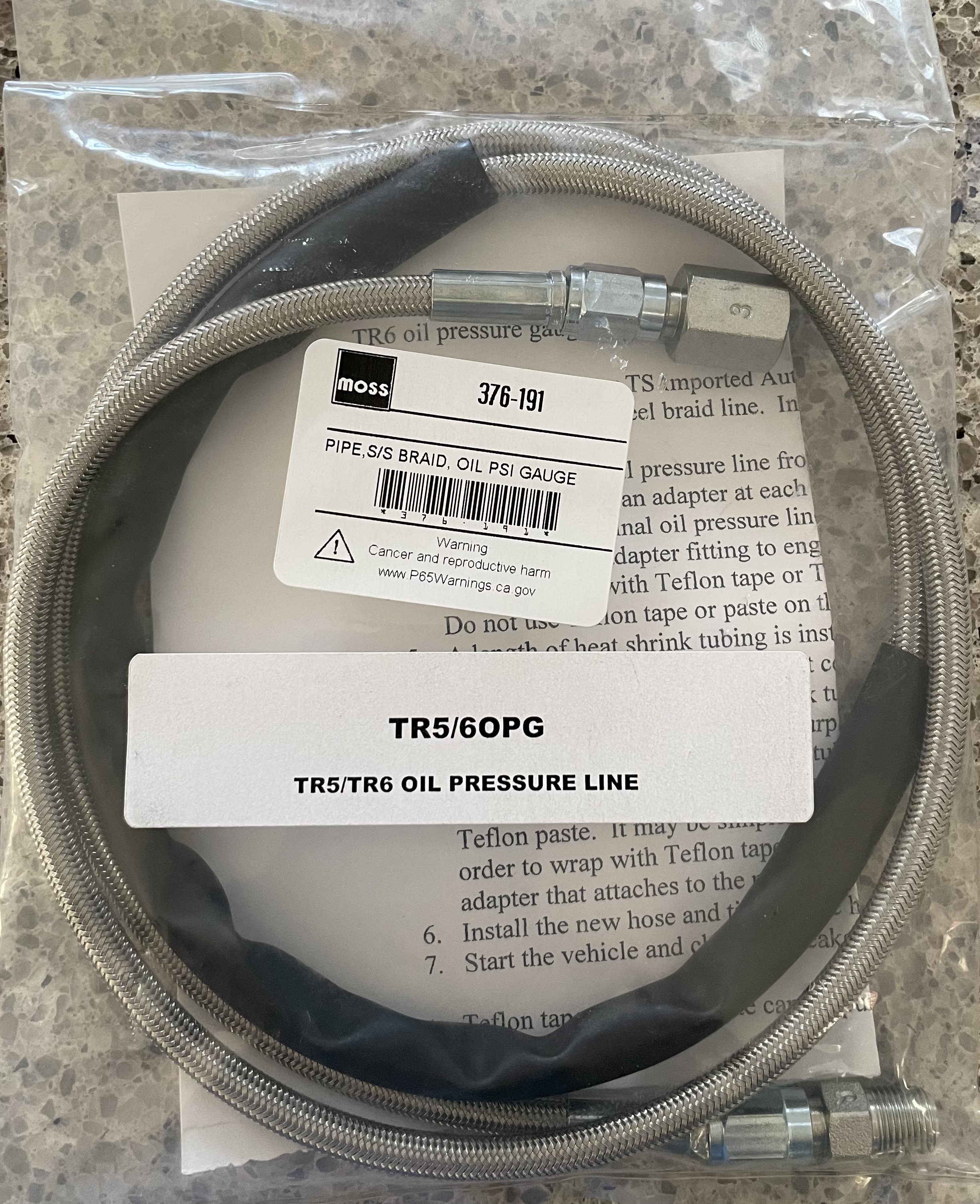

Don’t get a plastic replacement. As long as you are going to go to the trouble to install, get a SS Braided oil line. TSI has them.

Ordered braided oil line!! Thanks

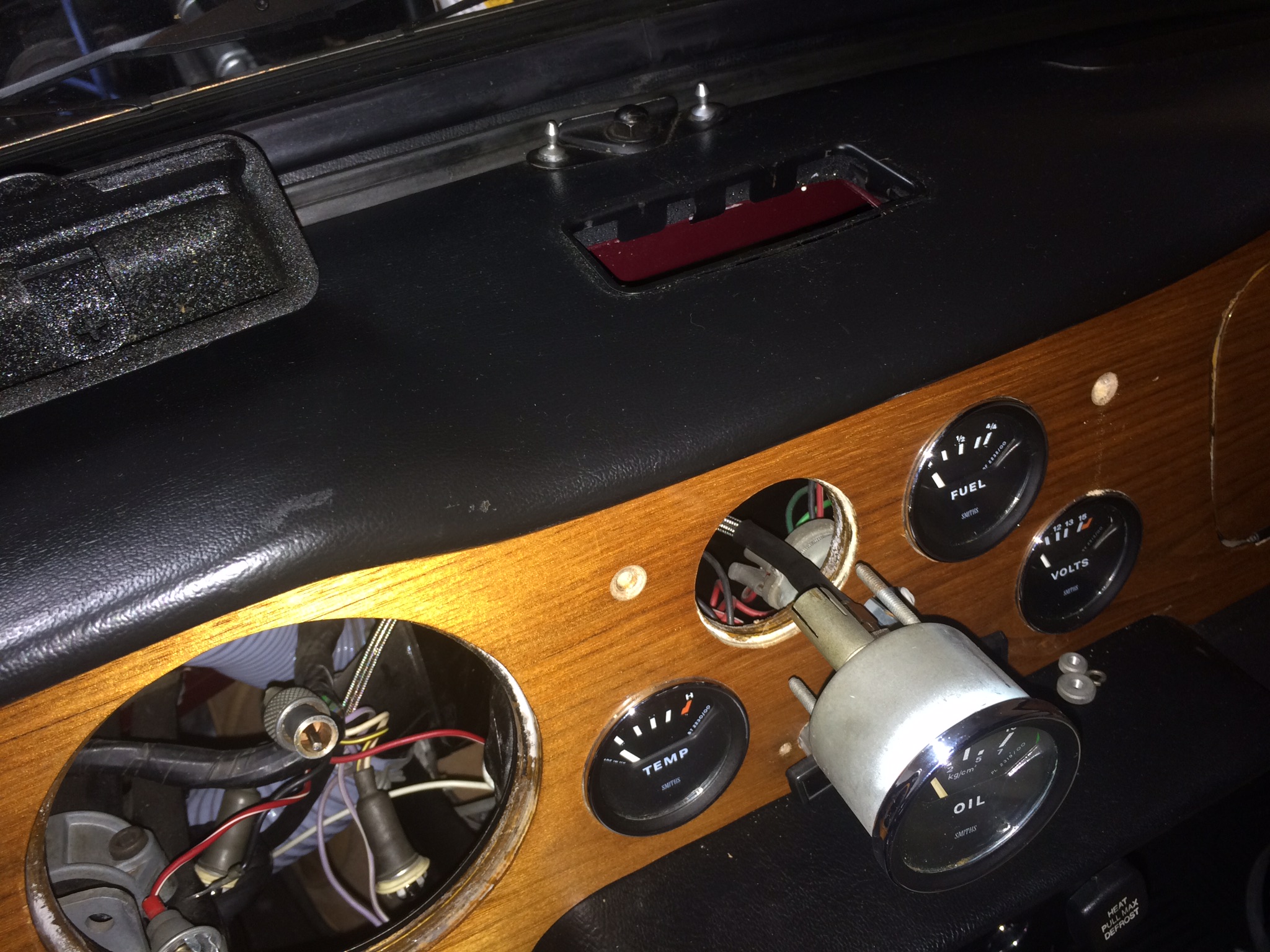

Just a tip… If you remove the ashtray you will be able to remove the oil pressure gauge in order to install the new line.
See post #4. Poolboy had it right before me.

As recommended- got SS braided line and will be installing it today.
