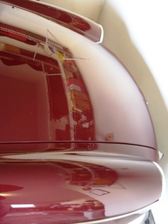

The Porter Cable 7424 is a universal favorite with many DIY detailers. I think I paid about $120.
I've tried just about every polish and wax on the market.
My favorite machine polish is 3M Finesse-It on a medium foam pad. For swirl marks, I follow it with 3M Perfect-It. Then several coats of Zaino. Mmmmm :smile:
EDIT: looks like Coastal Tool has if for $99. Good deal.
