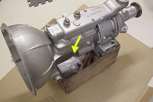

I think the plug is in the same place on a TR6 as on a TR4, here:

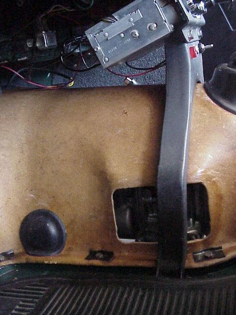

I cut an access hole in the tunnel but you can also get to it from beneath, then either pump up into it or run a tube up into the engine bay and set it up like an IV.
