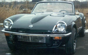

...Steve S...been painting for 30+ years. Done my share of show stuff.Its what I do..... Even the new cars need help to have show paint.
I was just assuming he wanted it to be free of ANY orange peel, and uniformly straight and level. That was my assumption as to why he wanted a machine... I may have read the post incorrectly....
