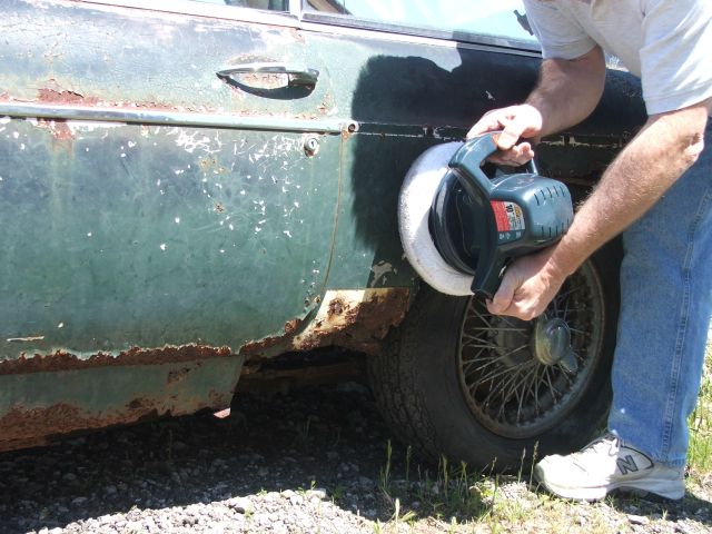

Mine was a little too powerful...or maybe the compound I was using was a little too gritty...just look at what it did to my sills!
:lol:
