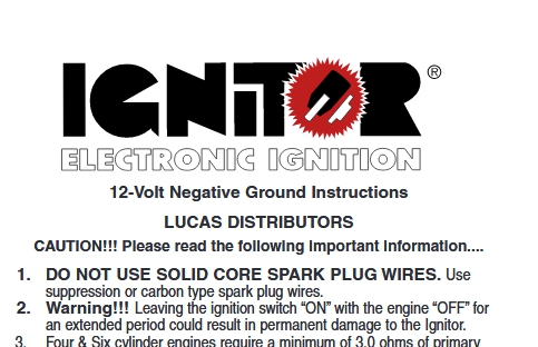

what is the issue with Pertronix and resistor Plugs??
Pertronix specs resistor wires; no mention of resistor plugs.
Please don't tell my Pertronix with appox. 100K miles on stranded--assuming that's what they mean, I've never seen solid plug wires--plug wires (with resistor plugs). I presume they mean stranded copper without resistor terminals or plugs; I can't for the life of me figure out what the (potential) problem is, as the wires are electrically isolated from the Pertronix by the coil.
I ran my Pertronix I for years using stranded metal wires, plain caps and resistor-or-not plugs -- with never any problem (no radio).
They're incompatible with the Pertronix II and maybe Pertronix decided metal wires weren't worth fooling with anymore.
Pertronix had a lot of issues when i visited them years ago'
MY position is I would not give up good reliable stranded copper spark plug wire for sting -resistor wires,
However , if you want to suppress electro magnet radiation from your ignition system then do as Steve
mentioned earlier of resistor wires, resistor caps or resistor plugs, you only need one
