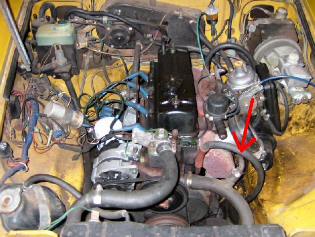

Hi, folks! Seems it's just one question after another for me so here's a new one concerning my '79 B.
I had the carb adjusted by a mechanic last week and haven't really looked under the hood since, but today I was checking the oil and saw this hose leading to, well, nothing! The smog stuff has been removed and I'm hoping that it was conccected to that at one point but want to make sure. I think he might have moved it from where the disconnected end was hiding and now it has me concerned. At any rate, I see nothing for it to be attached to!

Looking at the Moss catalog under Emission Controls, my guess is it is the hose, breather, oil seperator to the carb. Bet he forgot to rehook it up. Assuming it was before the mechanic worked on the carb. I have a Weber Carb and it is hooked up. You might look on the other side of the carb(firewall side) and see if there is a place for it to go. However, the safest thing is to call the mechanic.

Okay, well now I'm going to sound stupid. The photo I posted was taken at the beginning of March and I've put about 2000 miles on the car since then with no problems. I really don't think that hose was ever attached since I bought it December. Exactly where on the carb is it supposed to go and was purpose does it serve???

The hose is the breather pipe. This is part of the crankcase emission control. The part it is connect to now is the oil separator/flame trap. This is connected to the controlled depression chamber that is between the piston and the throttle disc valve of the carb. (if I am reading Bently correctly)

Check with your mechanic would be my advice. From your pic it looks like your car has been de-smogged. I think I see some parts on there that for some reason they left and some the took off. I have a 78 and it is connected to my Weber.

Yes, I have been desmogged and still got thorugh emissions with flying colors, I might add. If only that hose would improve the sound system! Thanks for the info...
