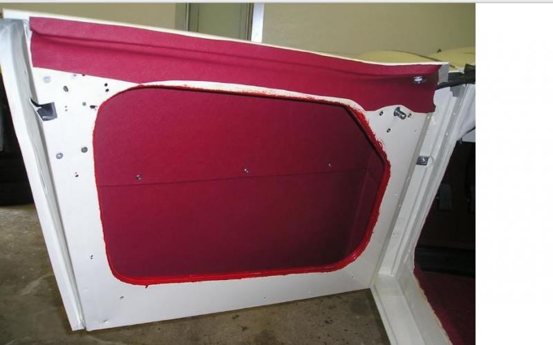

Im ready to install door-cards and need to get some of this "tape" for the top. Can you look at this link, notice the red "tape" along the top and please let me know what its called. Ive asked Moss, no love and searched vinyl tape and nothing....Thank you!!
Not my car but need the same stuff in black....

Hi Randy, dorry guys, nut sure why the link didnt work but heres a pic... What is the red stuff at the top of the door frame called???

Kurt,
That's flat vinyl, glued in place ( contact cement works ). Supplier of the door cards may have included a roll of matching vinyl. It is on the cars with side curtains to cover the gap between the cockpit surround aluminum and the door panels.
