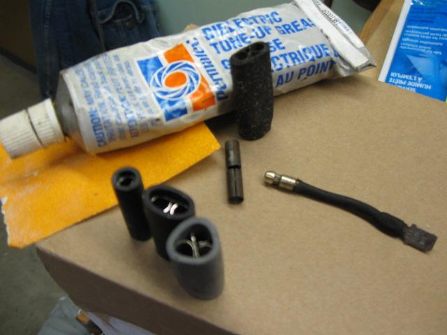

Make the bullets look like this. I got a supply of female connectors and went through everything I could see and either replaced the entire connector after buffing the bullets and dabbing on some grease and just reconnecting them or brushing the inner pieces and re using them if they looked ok.
There are singles , doubles and triples as pictured.
This will do a lot to solve your problems. Some of the good(original) connectors have a copper or brass inner piece,I think the new ones are just tin though. :cheers:
