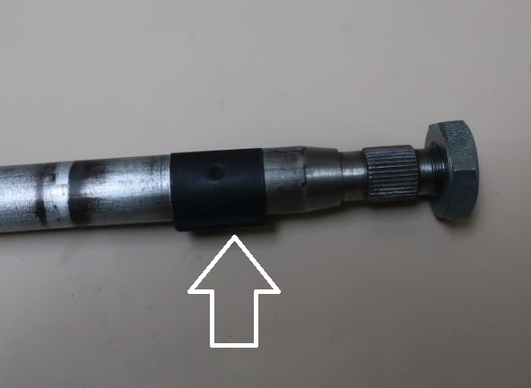

Since this has been solved I will ask a related question. What actually cancels the turn signal when activated? I just finished my restoration and my turn signals do not cancel after a turn. Using regular bulbs. Bruce
mezy
there should be a cam on the top of the steering column, would have a notch in it to lock to the steering wheel
which flicks the bottom of the stalk to turn them off.
Sarastro
This isn't real clear, but maybe it will help. That dark piece is made of spring steel and it clips onto the steering column. It has a cam, indicated by the arrow, which flicks one of two small levers in the turn signal switch when you straighten out the steering wheel.
There is a depression in the spring piece which fits into a hole in the steering column; you can just barely see it in the picture. That prevents the clip from sliding around.
This is from a TR4A. I don't know if it's the same on other cars.
bammons
I think I have that piece in one of my boxes. I just got a new steering wheel and I was wondering if this clip can be put in when I remove the original? Bruce
