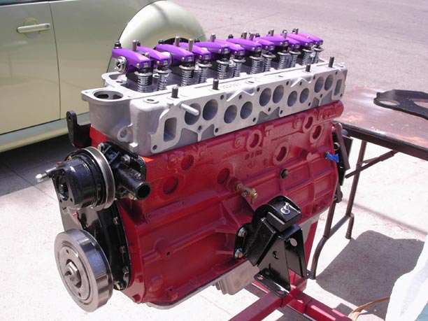

Option B: Don't rebuild, get a new roller rocker assembly. This is a higher ratio 1:1.55 from Rocker Arm Specialists mentioned in your other thread. They have a 1:1.5 also, which is closer to stock.
steveg
I used the 1.6 from Rocker Arm Specialists with no problems other than a need to shim the banjo oil fitting with a couple of extra copper washers in order to give clearance over the rocker itself.
Be very careful of the banjo bolt--they strip easily.
