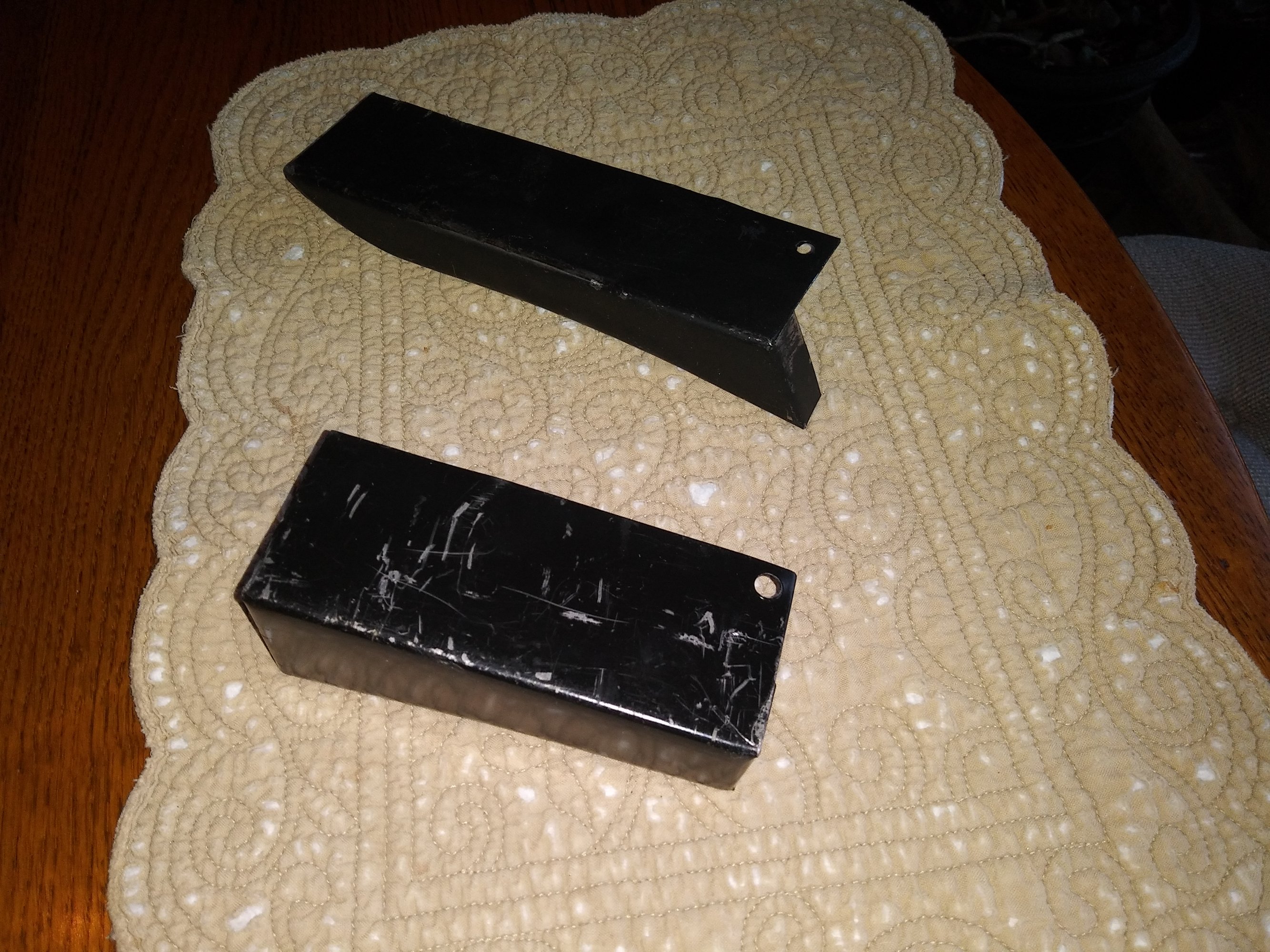

Is there a right way to install the front and rear rocker panel end caps? The ones I've purchased have 1 hole on the flat side that butts up against the body sheet metal. Do you just install with one screw so they can be removed later to access inside the rocker panel or is it best to weld them into the body sheet metal?
Another question is about the door handle gaskets. The ones that came from Moss in a body rubber kit are almost paper thin, looking around saw some new old stock from England wondering if they look like a better seal. Not messing with the trunk handle seal, it seems in good shape and made of rubber.

I had to replace 2 on my 67. The others were welded in so I did the same. I did shoot both sills inside with a lot of Rustoleum rusty metal primer then paint first though.

Thanks Bayless, wasn't sure what to do but welding does sound like the strongest way to attach them. I painted both sides of the inner sills after welding in with Por 15 and covered with black enamel spray can paint, also both insides of the rocker panels. Had to mark and grind off about a hundred spots before welding but easier than grinding down the welds were.
