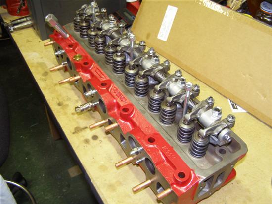

If you look at this picture, you will see a cotter pin in the front of mine:
Keep an eye out for the split pin that presumably fell out. With luck it will still be around in the area covered by the rocker cover. If not it went to the pan. Those magnet type oil pan bungs are worth the effort of installation.
