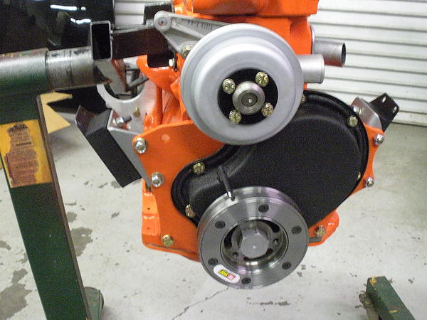

I use grade 8 bolts, washers, and nuts in many places not really needed for the reason grade 8 hardware come in yellow zinc plating, rather than white zinc (grade 5), or black oxide. I don't need a grade 8 bolt for the timing cover, or oil pan, but I like the yellow zinc color, so that's what I use.
