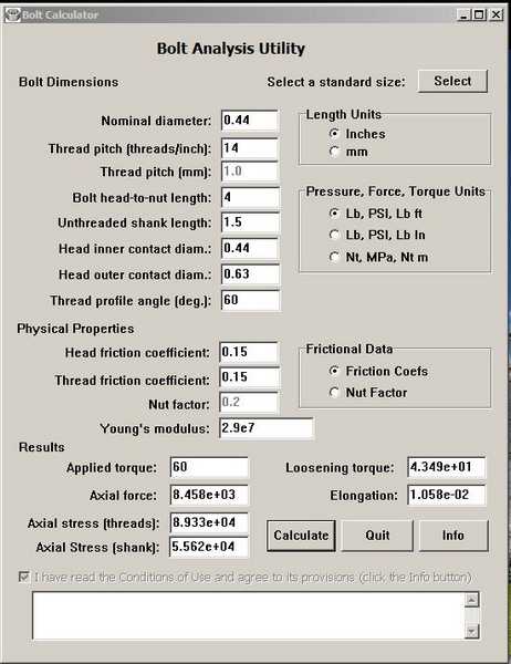

Oh, and to answer the original question...while doing this study, I wrote a little utility for calculating stress in bolts. I have to caution you that these results are a little soft, as they depend on some assumptions and are quite sensitive to certain parameters (like, friction in particular) but I think they give you a decent ballpark estimate of stress. I get about 90,000 PSI stress in a 7/16 inch main-bearing cap bolt, torqued to 60 lb. ft. That's well within the yield strength of a grade 8 bolt, so I don't see any problems in reusing them, as long as they are otherwise in good condition (no bunged up threads or anything like that).
