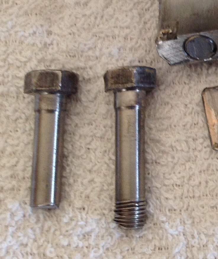

The latest connecting-rod bolts for the TR4A are "stretch" bolts. They have a thinner section that allows more elongation as they are tightened; the elasticity of that section tends to help prevent them from loosening. I don't know, but suspect that the TR6 bolts are the same. I don't think they are strictly single-use, but by time you need to rebuild the engine, probably they should be replaced.

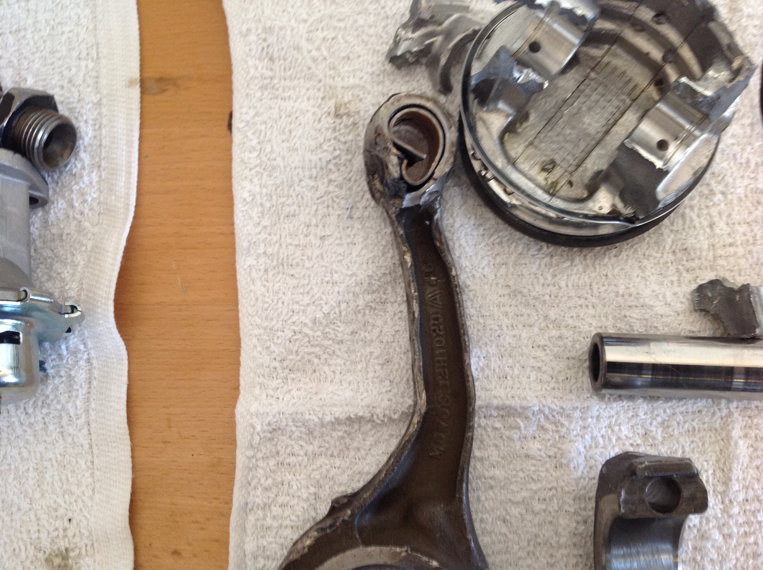

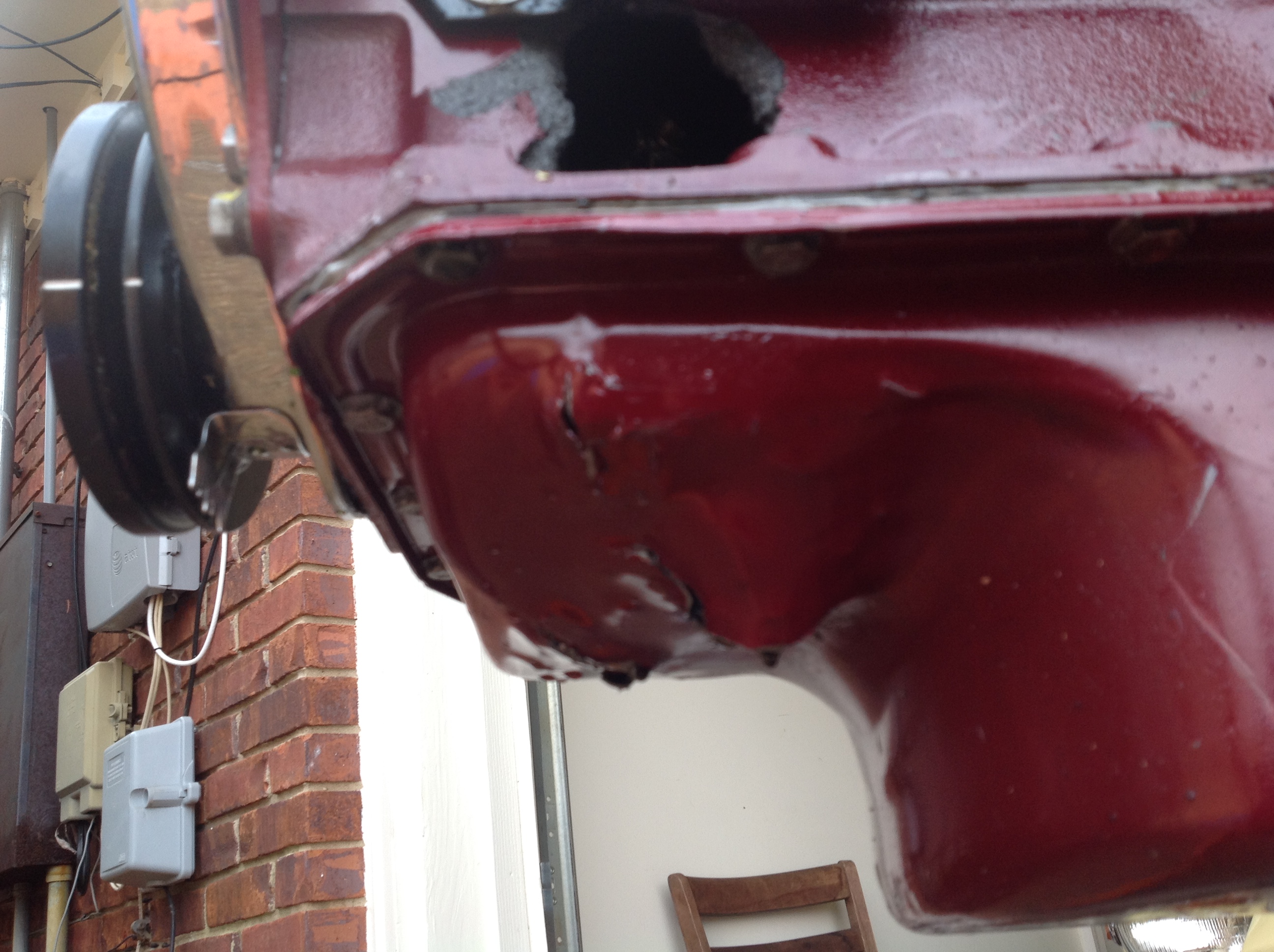

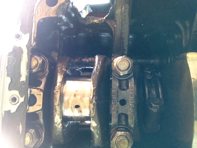

I have heard expert opinion that you can reuse crank bolts. I also am aware of one case where a reused crank bolt broke and destroyed a newly rebuilt engine. Those suckers are expensive, I know, but they're still cheap insurance.

I’m always conflicted on main bolts, but rod, head and flywheel bolts get replaced with ARP on my rebuilds. Once upon a time I reused rod bolts on a hot MGB engine rebuild after the machine shop and I both measured them and pronounced them good…won’t do that again!
