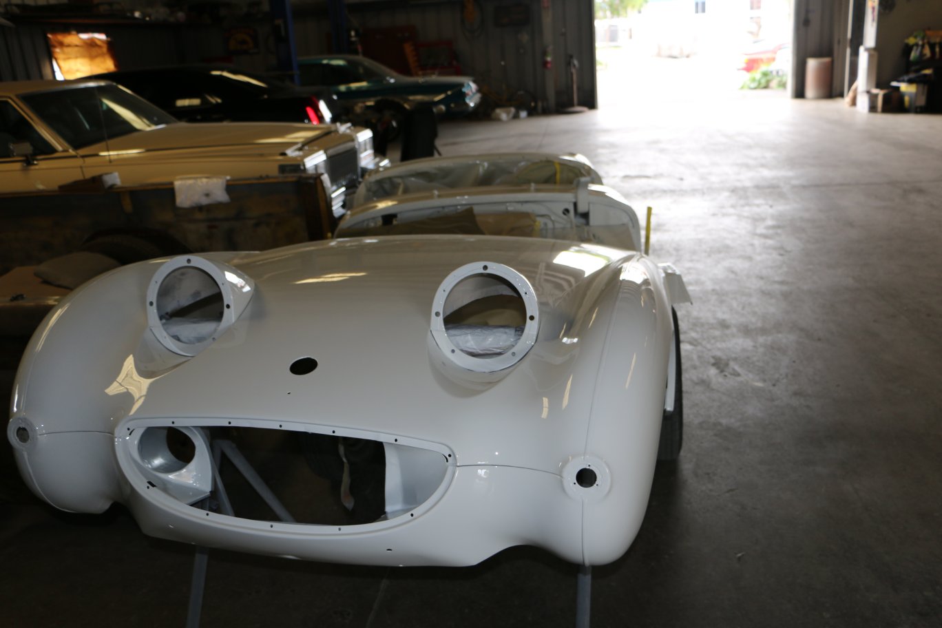

Thanks I will do that But right now it is getting painted will be done in 3 weeks. Premier body and paint is doing it. Started on in February H6.jpgS4.jpgS3.jpgS2.jpgS6.jpg
JPSmit
Now you're just showing off. :grin: seriously - it looks gorgeous!!!!
