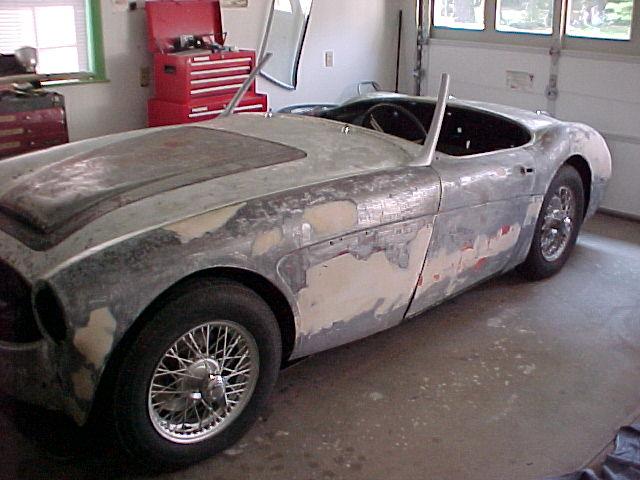

Most assemble the fenders onto the shroud loosely, then paint, allowing paint to go down into crevice. You can tighten later on. Of course you can paint the inside of the fenders off the car. When it comes time to install the fender beading don't forget to tape the sharp ends before sticking in the crevice formed from the fender to the shroud. Click on the attachment above for a photo of my car ready to be painted.

Hi Johnny thats something like what I was going to do. I have the fenders and shroud already painted color sanded and buffed out. This is how I am able to get a really glossy finish right up to the beading. No one will ever see it but the shroud and fender flanges are a glossy as the outer parts.I was going to install the beading without the fenders on the shroud then bolt the fenders on loosely and slip the entire thing over the car. I took them off that way I don`t see why I can`t put them back in the same manner. Skip
