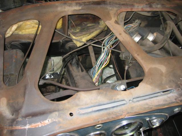

The product i used was a high density closed cell type if i remember correctly, It worked very well! I don't think the factory was thinking in terms of moisture retention! The original material was a very cheap looking product and the bulk head had some open face insulation stuffed in there! I will try to dig up some of my restoration pictures and the original materials the factory used if anyone is interested. Note: the open face insulation from the factory...Nice to inhail all those particals through the vents as we motor along joyfully!:sick: 2006 Austin Restoration 030.jpg
