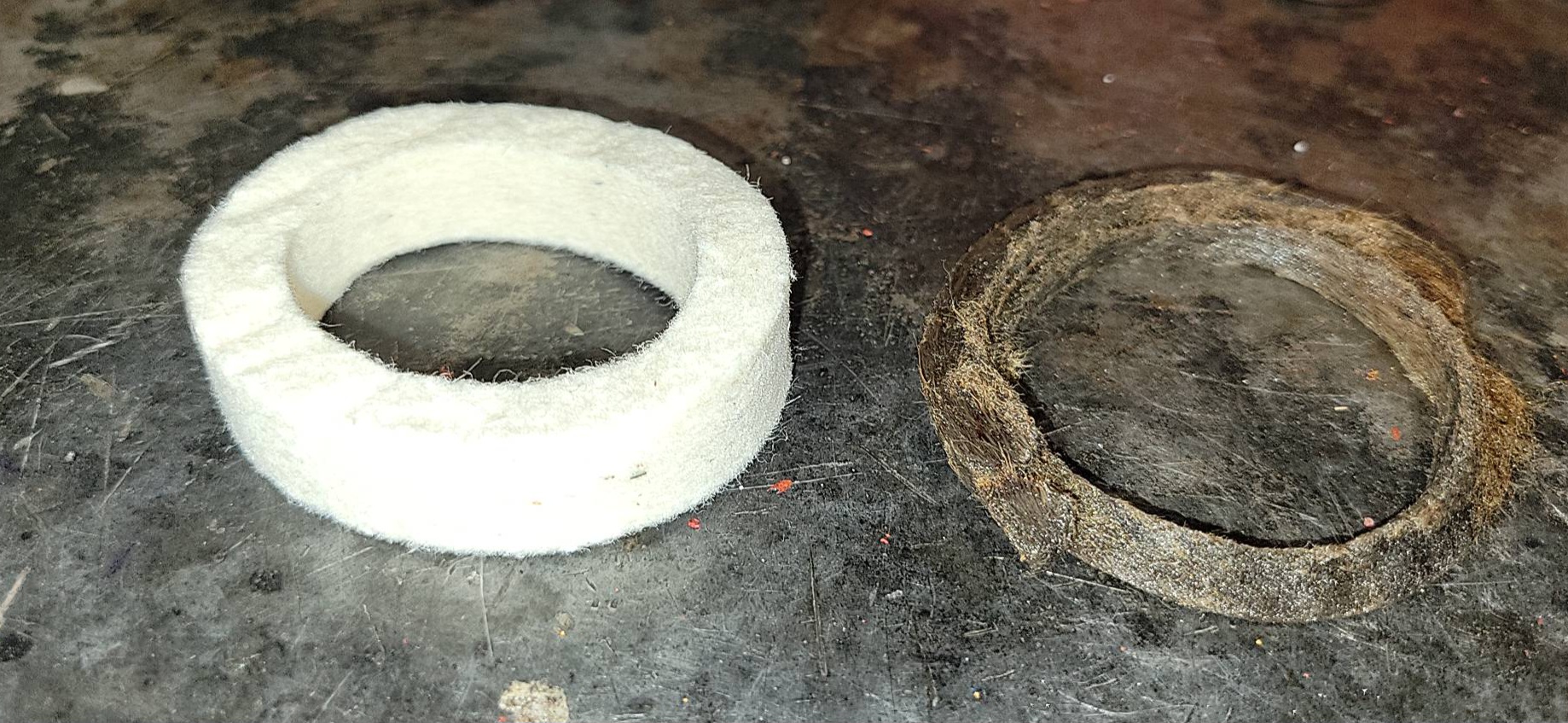

Thank you for your replies. I forged ahead with an original type seal after removing what was left of the old felt seal. As you can see from the picture, there wasn't much left. The new felt seal from Moss is about twice as wide as the channel in the timing cover. I've got questions! Are these supposed to be trimmed to fit? I've tried wedging it in with no luck. Are they supposed to be saturated with grease or oil to get them wedged in?
I am open to and appreciate any other tips to make this a one-time replacement.

If you're still thinking about it get the BCS upgrade--it will undoubtedly outlast a felt seal. I put one on about 10 years ago and when I had to remove the cover to replace the timing chain and tensioner the seal was in like-new condition.
