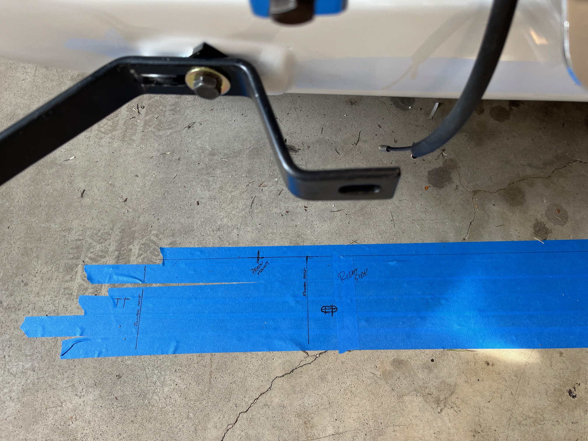

I worked it in reverse and I think somebody was mucking around with the brackets for some reason. I shifted them shifted outboard as far as possible and am still 3/4” off on each side when I drop lines to the floor. You can see the location of the mounting hole sketched on the floor relative to the bumper hole location designated by the line.

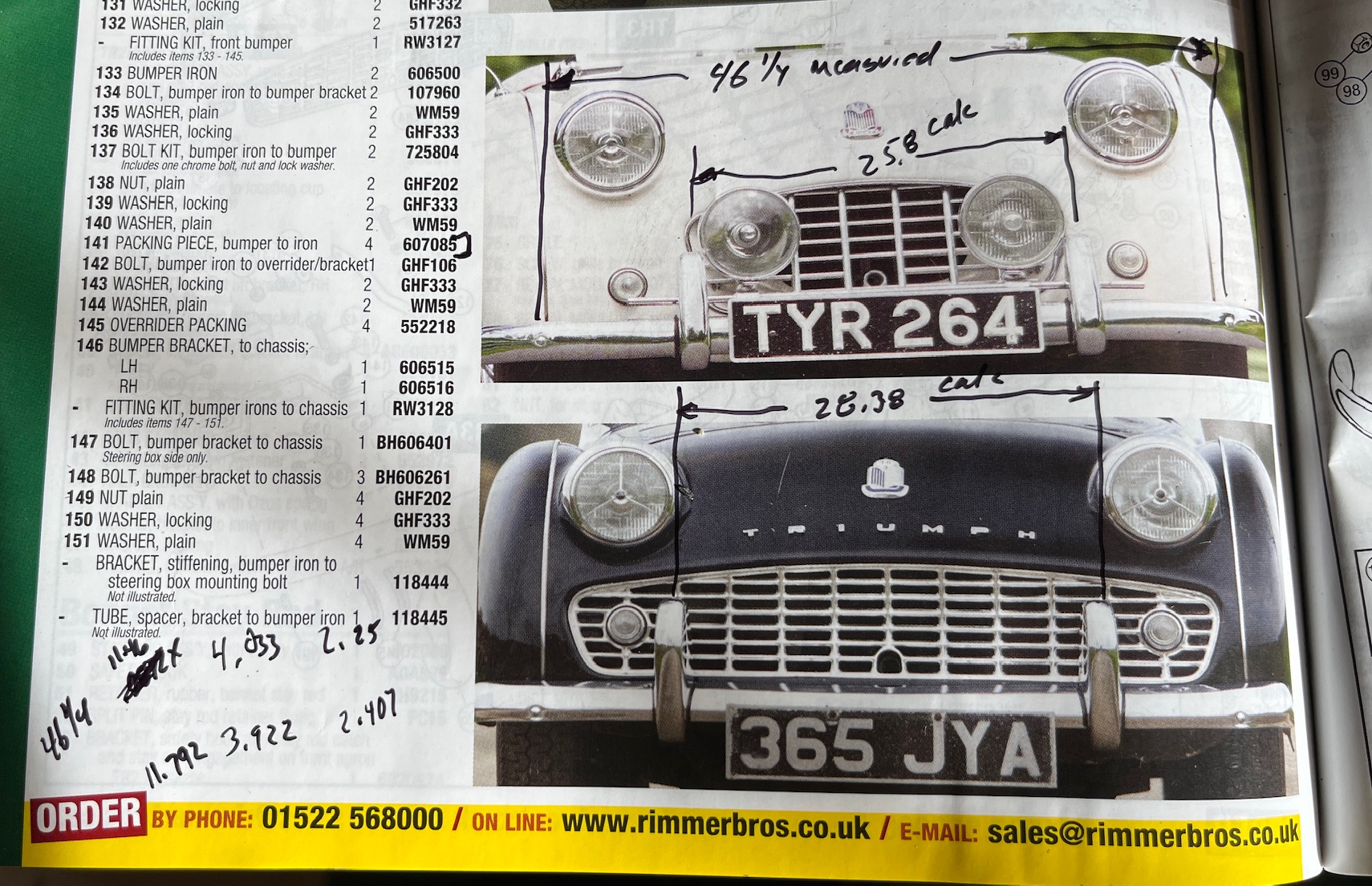

I also scaled the photo in the Rimmer catalog to see what the dimensions should be. Using the outer holes as a reference (measured 49.25 on my bumper) since they appear to be in the same location on TR3 and TR3As. I measured the distance between the overrider mounting holes at 28”. I then measured and scaled the distance from the Rimmer photo and calculated 28.38 which confirms I have a TR3A bumper.
This tells me something is seriously out of whack with the brackets.

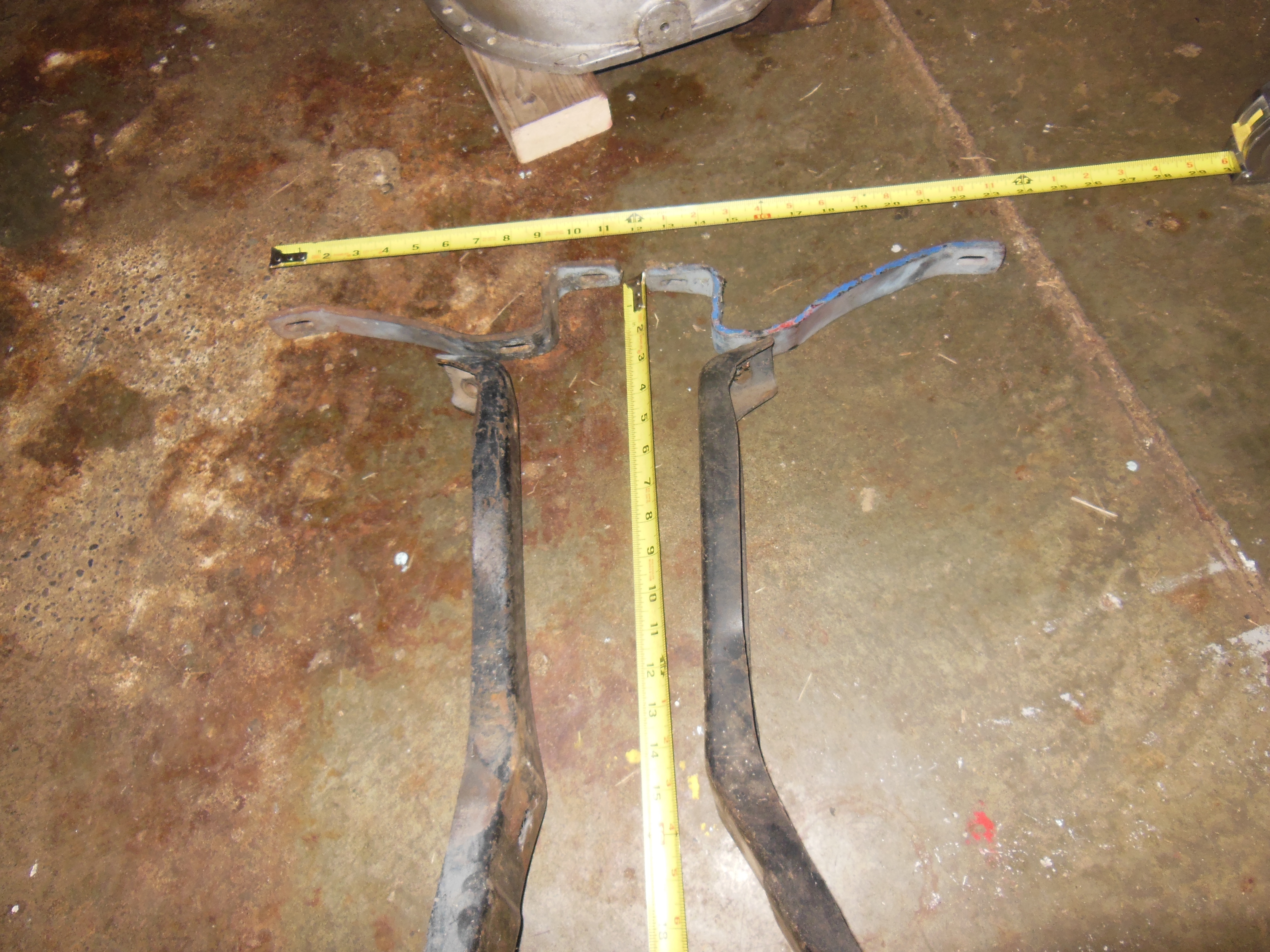

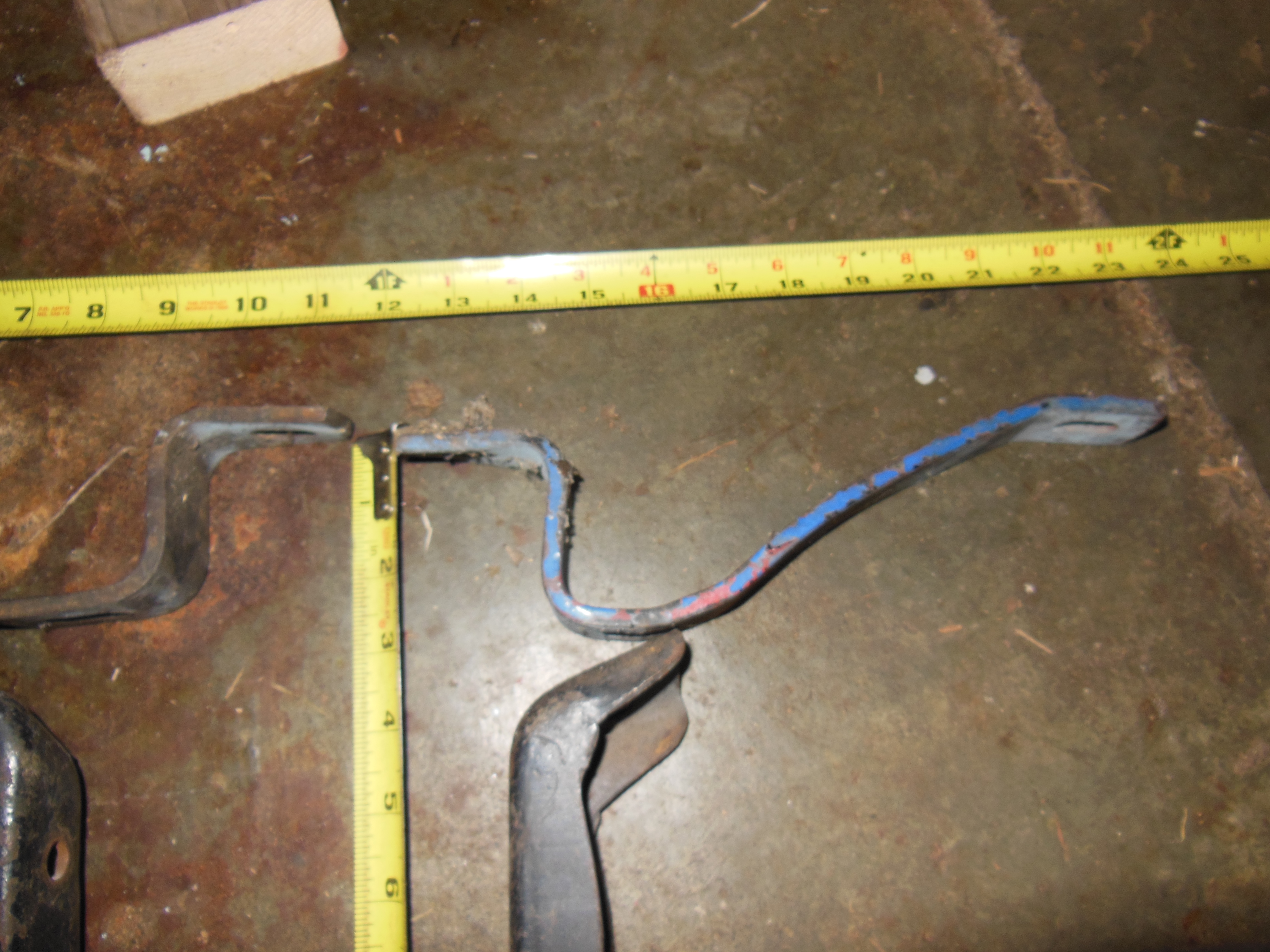

I took some pictures of some brackets if that helps? Tell me again what exact number you need, and I will get it. I have a tr3a and tr3 here.
steve

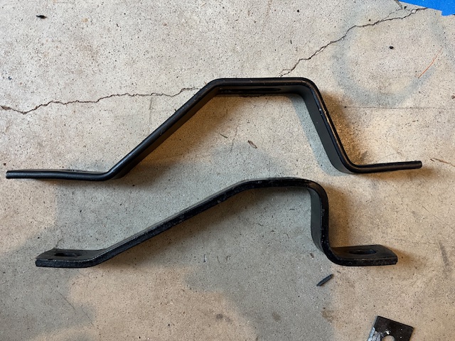

Well, I ended up ordering TR3A brackets off Ebay and they arrived late last week. They are the same as the DSCN1689.jpg picture that Steve provided (thanks!). The TR3A bracket I received is on the left in the image below, the mystery bracket that came with the car is shown on the right.
I have no idea which car the right bracket fits so they're going in the scrap bin.
Thanks for everyone's help and guidance!
