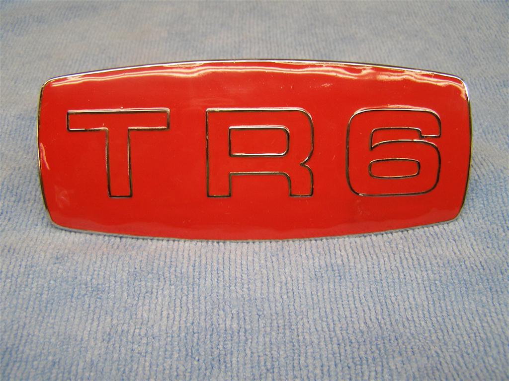

Brosky
I wanted to change the color on my TR6 badge (a spare actually) and a friend of mine in the jewelry business in Providence applied a cloisonne for me. He does have the ovens to fire it properly, but doesn't want to do this kind of work.
