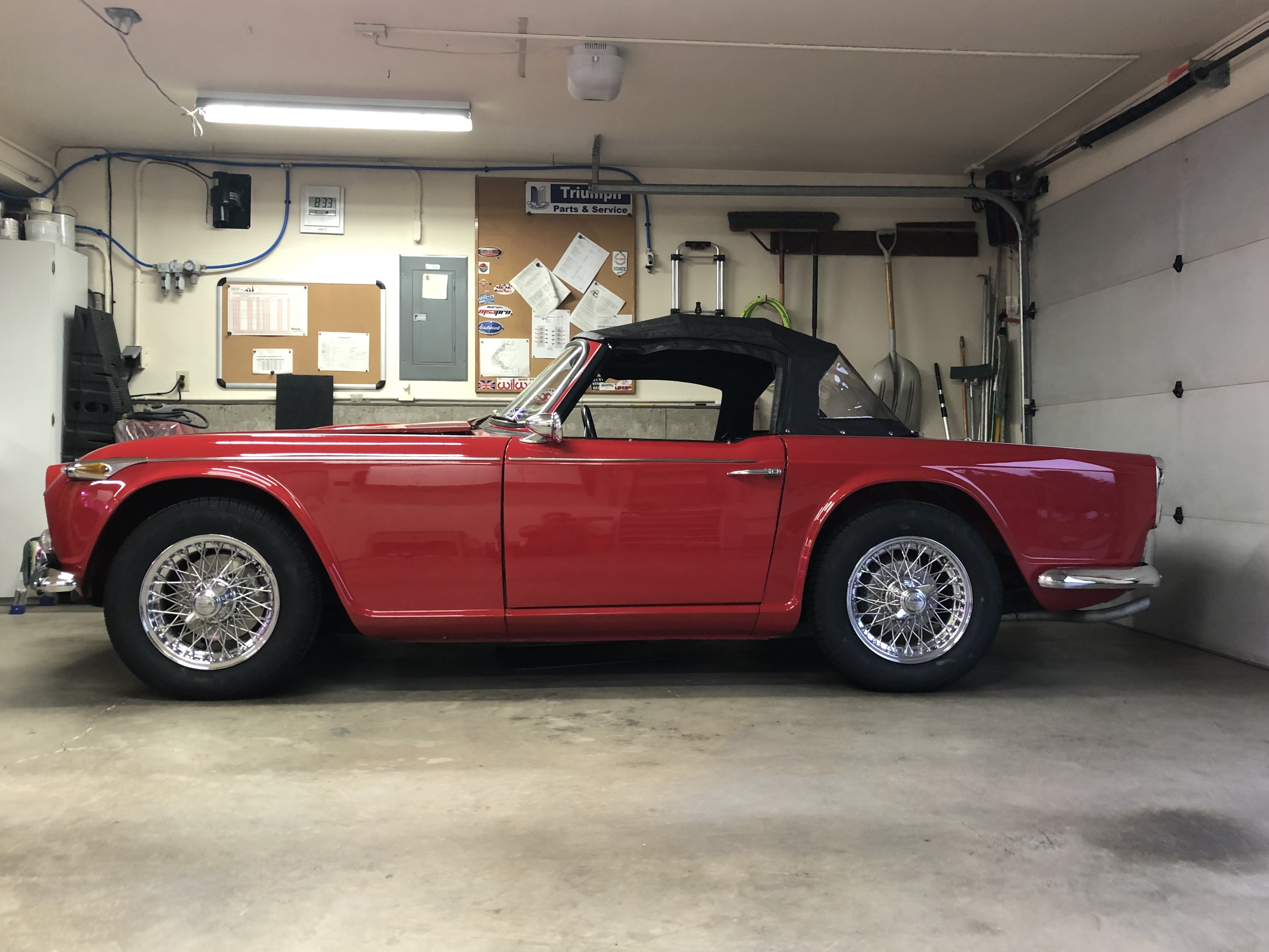

Beautiful car, Darrell - hope mine looks a little but like that when I’m done!
