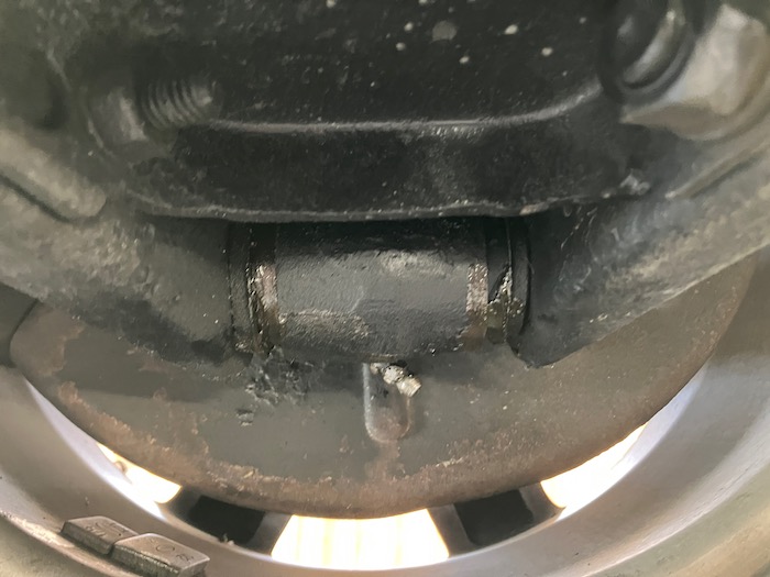

Was under the car today doing my usual spring maintenance (God Bless a lift!) and noticed that the seals on the front suspension -- lower trunnions? -- are shot. L side was just dangling and crumbled away, and the R side is looking pretty tired. So now I get to dig in and do at least a partial front suspension rebuild.
My question for the assembled minds is this: what is reasonable to do here? Is this just a quick project to replace what's obvious, or am I pulling the front crossmember to rebuild the whole shebang. Thoughts?
I'd rather not have the car off the road for long, but the Morris is running great so it can take the time it will take. Would love to hear your thoughts.

I would do it all and do it right - If the Midget is anything to go by it isn't a huge job.
Platinum
I'd say dropping the crossmember may be a bit of overkill. Unless the kingpin bushings have been neglected (lacking regular grease sessions) and need replacing, it's a fairly straightforward R&R of the seals and bushings in the damper arms and lower trunnion. And look for wear in the lower a-arm holes where the through bolt fits. Have seen MANY trashed due to lubrication neglect. Get the poly bushings ahead of time for the a-arms too, they make a big difference in handling.
Is there a sway-bar on yours? If you want a real reduction in body roll at the front-end, the bar used on the MGB-GT makes a difference as well. It's a larger diameter than the roadsters were fitted with.

Thanks for the thoughts, Doc. I've done my best to keep things greased over the years, but the suspension is something I've not messed with since I bought the car in 2011. I'll try and get at least one side somewhat apart this week and will let y'all know what I find.
I'd rather just do bushings and seals if I can, as I don't want the car off the road for too long.
Poly bushings all around?

We did that to a couple customers' cars and it convinced me to put them on our own B. Bit more solid in terms of ride but a nicer more "crisp" reaction to driver input. If you were just going out on sunny Sundays for ice cream it wouldn't make much difference. But "spirited" driving makes it apparent you've made a good modification. (y)
It looks like you've a sway-bar already, if you want a bit more roll stiffness after you've got all else in place, the B-GT bar is the way to go. The front-end can "wash out" at traction limits a bit quicker, but my guess is you won't try to find that on open roads! ;)
