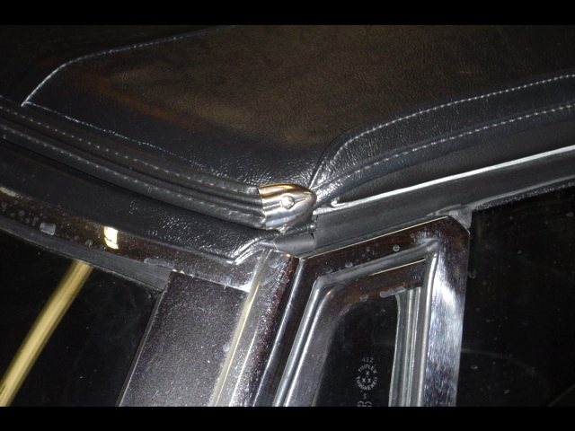

I've attached a photo of my new convertable top.
I need to know the correct placement of the strip that goes over the windshield.
Does it cover the long slot or does it go above the slot?

Here is another photo, which shows better the front of the top. The area in question, is where the wood meets the piece that touches the windshield. Does that area get covered?

Yes that is what the welt is to cover. My original top's welt has two of the ribs in it that face outboard.---Fwiw-Keoke

Here is a picture that probably answers your questions.

The strip (called a hidem strip)should have two welts. The twin welts close over and hide the heads of the tacks or staples that are installed between them. A small bead of caulking should be applied into the gap between the header bar and the top. The tacks are driven into the wood header bar and the hidem strip is carefuly positioned so it covers the gap.
