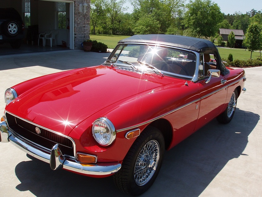

This is a Prestige top for my wife's 72 car which I ordered directly from them in the UK. The fit was perfect, but when the top came it had a misplaced stitch on one of the quarter windows and showed a slight gap. I told them about it, they wanted it back at their expense and they sent me another with no flaws. Took a couple of weeks. They were very nice about it. The top was a heavier material than a US-made top. PJ
