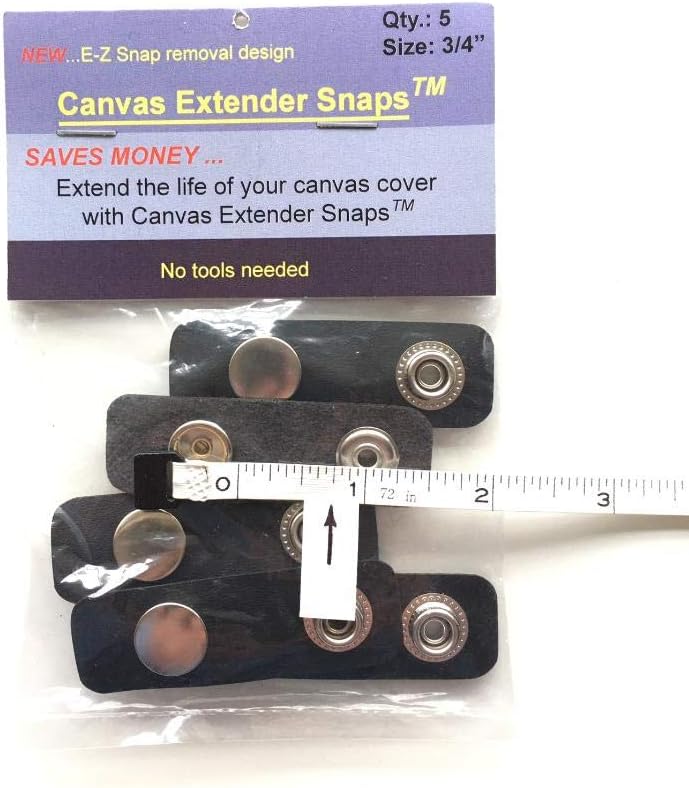

Just bought a restored 1964 BJ8 and the snap-on cover for the convertible top is too tight in one area, so it is almost impossible to pull the cover tight enough to snap it into place. I thought that the solution I found might be useful for anyone who has a similar problem with this Austin part. These snap extensions are canvas, black and can be ordered in varying lengths from Amazon for very little money: "Boat Canvas Extender Snaps Boating Accessories 5 Per Bag Improved Easy Release Tabs Black." I am going to use leftovers for a boat canvas cover where it is too tight in the corners.
Boat Canvas Extender Snaps Boating Accessories 5 Per Bag Improved Easy Release Tabs Black​

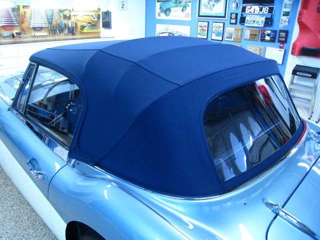

It's a good idea to keep the top erected when not driving. Helps keep it's shape and not get storage lines.
Another good idea. I like the clever call sign and the plate ID.
Thank you, Overdrive45, I have this exact problem and the extenders is a great solution for my top which is in great shape except it has shrunk about 1/2-1” short of being able to snap the side snamps.
Hi Tim,
I just installed 2 snaps this morning, and they work perfectly. Actually, I only needed one, but the other was added for symmetry. I was thinking about epoxying the extender to the cover, but it may be better to carry a couple of spares in the glove box.
