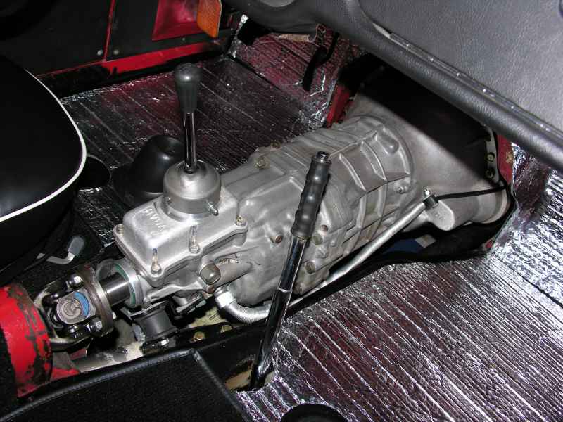

I have two different angle drives adapters, both attach at the gearbox and both are Toyota issue. One is a bent tube that forms a sweeping 90deg. and the other is a true right angle unit. I was told that many Toyotas use angle drives and they are pretty much universal amongst the models that use them. The right angle unit came with the last Supra tranny and I purchased the tubular unit from Toyota parts (for $70).
The 3A uses the tubular adapter. The cable routes 1) up away from the exhaust although I added ThermoTec cool-tube over it 2) forward and over the top of the gearbox towards the driver side 3) then out from under the battery box and 4) finally back through the firewall to the dash. I think that the original actually went through a hole in the chassis next to the gearbox then forward up and over as described above.
I don't have part #s handy - it would take some time to find them.
Here's the 3A with the tubular adapter:
-PK
