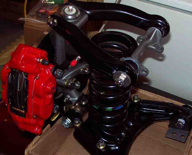

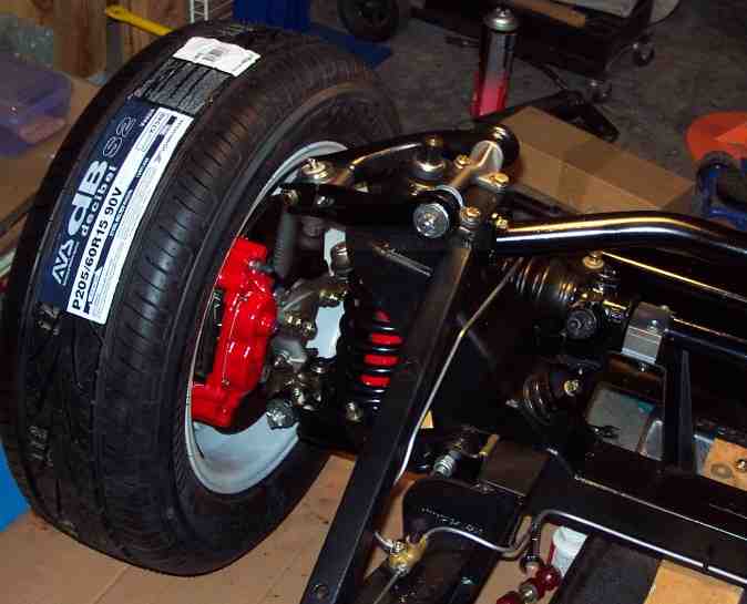

Here's what my fronts look like on my 4A.
First I did a dry assembly on the bench
Brosky
Nice job Peter. That is a classy assembly. The red calipers are just a bonus, Tom. But a nice one, indeed. And don't forget the shocks too!
PeterK
The shocks are Konis, naturally red.
