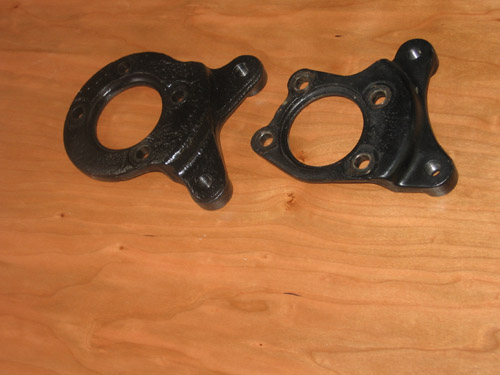

I did the Toyota brake conversion on my TR3. I bought some of the kit contents from Dr. Marty...the bling drilled rotors, the "metric" shouldered bolts and the adaptor line from the caliper to the flex line.
Since I work for an automotive remanufacturer, I was able to get the calipers right off the shelf...a perk. The bracket holding the caliper brake line to the flex line I made in the garage. And, you also need the caliper bracket from a TR6, as the bracket for the TR3 will position the caliper too close to fit over the rotor. That's why the kits aren't offered for the TR3. The pics show the assembled caliper, the brake line bracket I made, and the two different caliper brackets. The one on the left is the TR6 bracket I used, and the one on the right is the original TR3 bracket.
