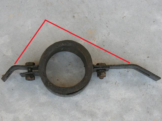

Here is a picture of the bracket, as you can see it has the two mounting ends arranged at right angles, indicated by the red lines I added. So this would suggest it should be mounted with one end on the horizontal part and one end on the vertical part. Hmmm...

Excellent picture! That is exactly where I want to mount it. I think that is where that standard pump in later models goes too.
How is the pump attached to that vertical bulkhead?

The mount is a 90 degree angled piece of steel; the mount is bolted straight onto the bulkhead (with shims / washers at the lower bolt holes, between the mount and the bulkhead wall to keep the mount plumb) and the pump actually hangs from the three posts with rubber 'donuts', just visible at the top.
It's not quiet, but it's not much louder than the electric pump on my modern VW either. With the car running, it's not noticeable.

Yes, that is exactly what I need. Many thanks.
