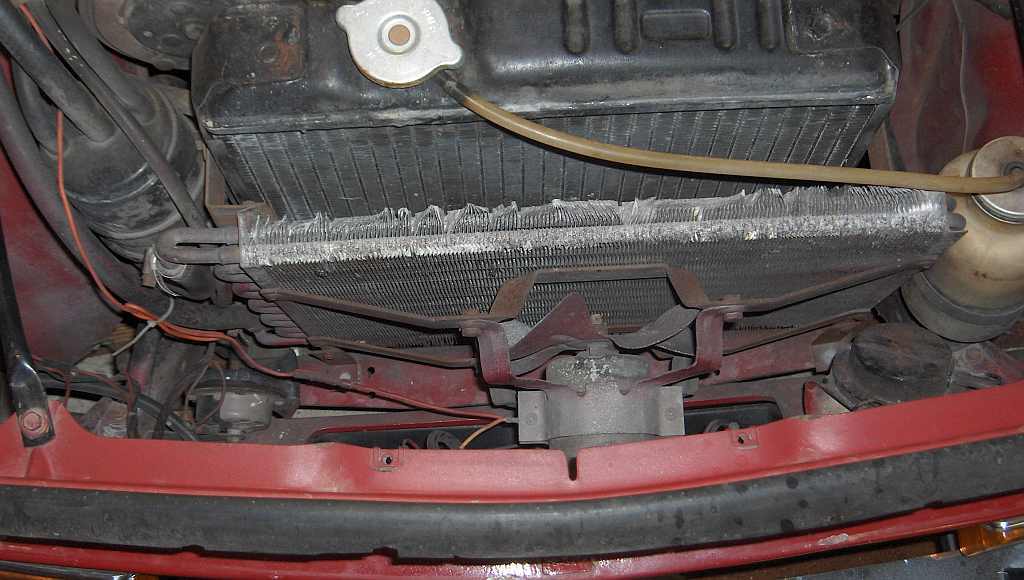

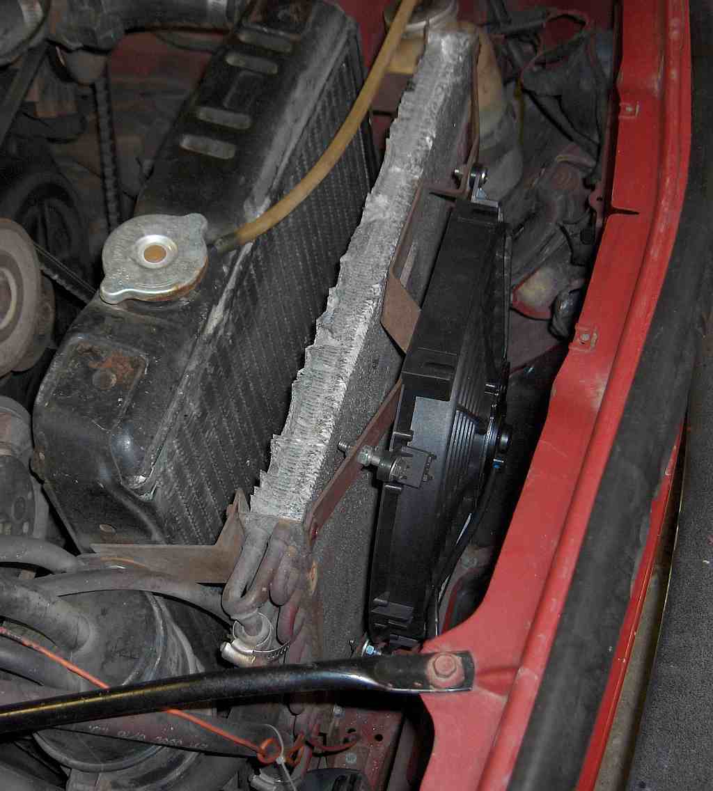

My TR6 was equipped with (dealer installed) A/C, which included a pusher fan as can be seen in this first picture. It would be turned on with the A/C switch through a relay. Living in Houston, and still having the A/C non-functional, I would occasionally have overheating concerns when stuck in traffic. I opted to use the same mounting brackets and installed a higher capacity fan, as well as a temperature controlled relay to enable it. I did not remove the original belt driven fan. The cardboard fan shroud would not fit because of the condenser, but I did add a fiberglass top plate to direct air through the radiator, instead of over it. Since then, I've never felt the car was about to overheat, and I've often heard the fan turn on and off. (I've also installed a higher capacity alternator to provide enough power for the fan, but that's another discussion.)
The original auxiliary fan is a joke.

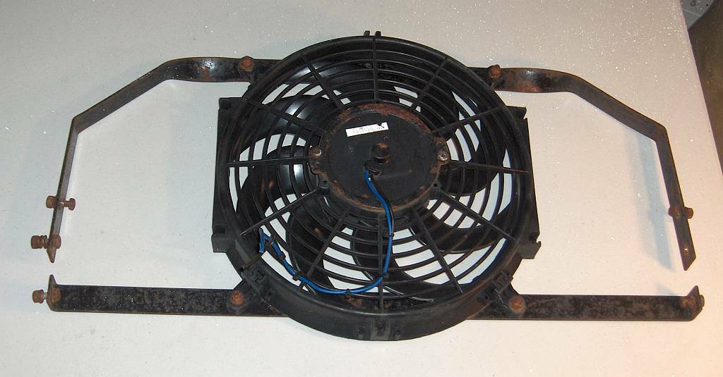

Another option is what was done on my TR3 before I got it. Two flat metal bars with holes drilled were bent to support the fan. Six holes were drilled on each front fender and the whole thing mounted in front of the radiator. The PO drove the car in the heat of southern Mississippi and had a toggle switch to run the optional fan. He claims it worked well and didn't interfere with the hand crank. I'll probably put it back together that way even though I need to take the radiator back to the shop to have a leak fixed.
