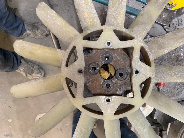

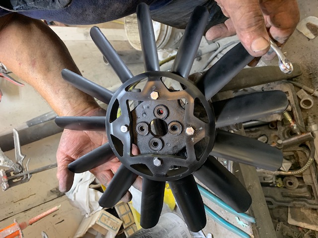

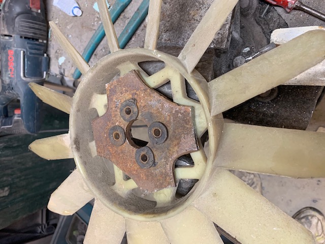

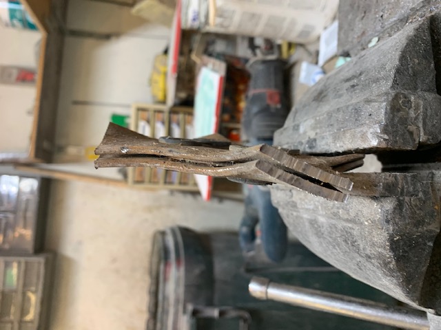

For many years I have been converting ALL the tr3's(and 4's) I have worked on to Tr7 fan blades.
No car done this way ever gets hot in traffic on 100deg days.
The old paddles are cut off ,the hub is flattened ,drilled and bolted up .
NO clearance issues,13 blades pull a small hurricane of air through the rad.
Lighter and better.Pulls more air than the 250 fix and is still a factory part!
